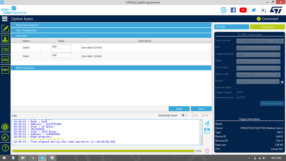

what is use of user data in option bytes programming?
parth kothiya
Senior
0693W0000059Y3bQAE.bmpI want to know what is use of user data in option bytes programming?
it helps to protect my firmware inside MCU like password or etc?
It's for whatever you want to put there. Basically a 2-byte EEPROM.
