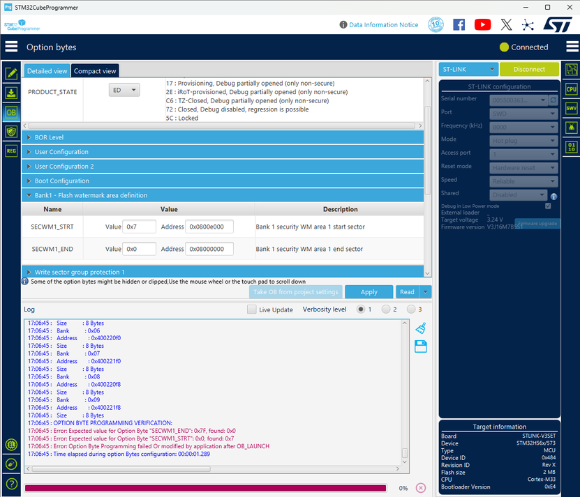

Hello @Thatseasy,
I have applied the same OBs you provided, and I am able to change OBs, however due to the secure watermark area the FW download verification fails and that's a normal behavior. Can you try to manually set SECWM1_STRT to be greater than SECWM1_END or disabling TrustZone ?

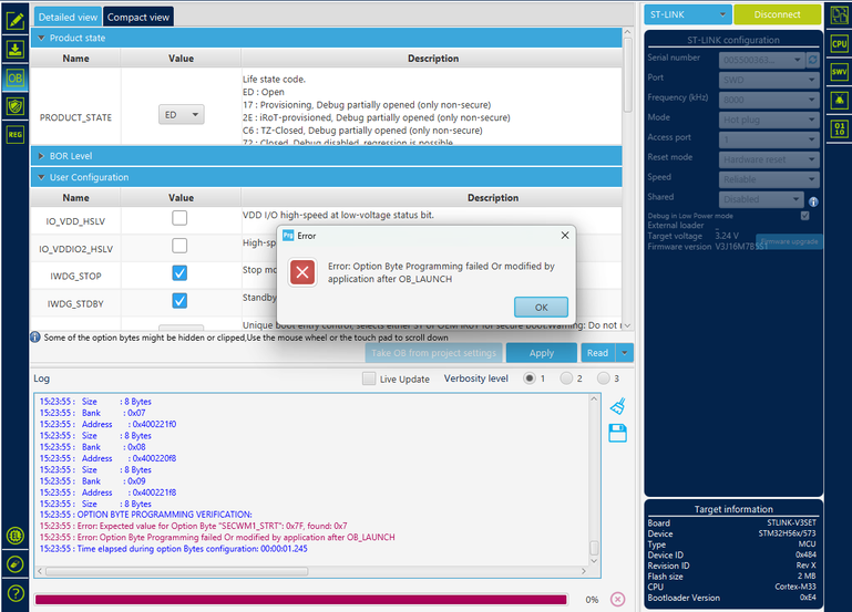

‎2025-05-09 1:05 PM
@Amine_Jridi The TrustZone was not enabled, not sure why UserConfig2 TZEN had 0xB4, but I was able to change it to C3 from the GUI. Tried to set SECWM1_STRT to 0x7F, got the following error:
Not sure the option bytes are the problem, but as mentioned earlier, the board started to have problems after a call to HAL_FLASHEx_OBProgram() which I suspected something got messed up.

‎2025-05-28 7:49 AM
Hello @Thatseasy,
Currently, the factory reset feature using CubeProgrammer is only available for the STM32U5. However, it will be included for the STM32H5 in the upcoming release v2.20.
Regarding the issue you're experiencing, I am not sure about the root cause as it functions correctly for me. The errors you're encountering when trying to change SECWM1_STRT are expected after setting TZEN to C3 (disabled). Once TZEN is disabled, the flash watermark area definition for BANK1 & BANK2 should disappear.
I've submitted a change request to the responsible team to address this matter.
Internal ticket number: 211054 (Please note, this is an internal tracking number and not accessible to customers).
