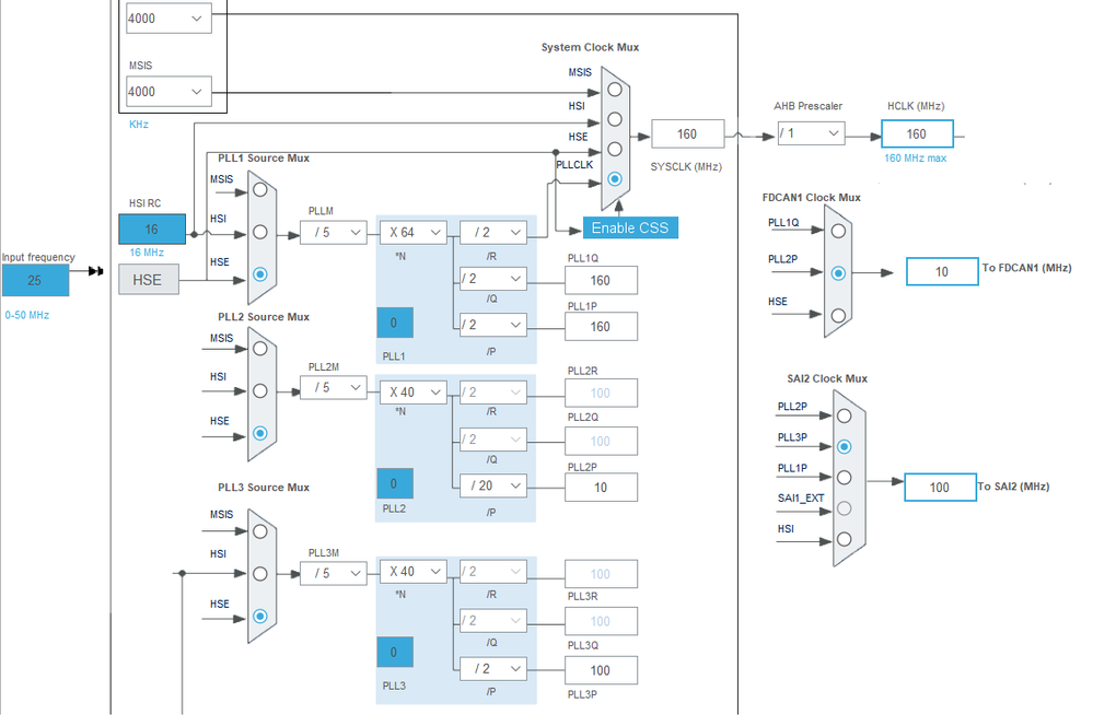

In my project I need CPU frequency independent CANBUS and SAI2 Master clock output.
CANBUS is running out of PLL2P clock, while SAI2 MCLK is selected from PLL3P
If I only enable one or the other, they work great, but if I enable them all together desister ! My CANBUS traffic is just garbage and it hangs while the SAI2 clock is good. They are all on completely different PLL’s I don’t understand how it happens and how to fix it

And peripheral PLL2 and PLL3 configuration that is done before any SAI or FDCAN
void PeriphCommonClock_Config(void)
LL_RCC_PLL2_ConfigDomain_SAI(LL_RCC_PLL2SOURCE_HSE, 5, 40, 20); // 25 / 5 * 40 / 20 = 10MHz
LL_RCC_PLL2_EnableDomain_SAI();
LL_RCC_PLL2_SetVCOInputRange(LL_RCC_PLLINPUTRANGE_4_8);
LL_RCC_PLL2_Enable();
uint32_t timeout = 0xFFFFFF;
while(LL_RCC_PLL2_IsReady() != 1)
timeout--;
if(timeout==0)
break;
LL_RCC_PLL3_ConfigDomain_SAI(LL_RCC_PLL3SOURCE_HSE, 5, 40, 2); //100MHz
LL_RCC_PLL3_EnableDomain_SAI();
LL_RCC_PLL3_SetVCOInputRange(LL_RCC_PLLINPUTRANGE_4_8);
LL_RCC_PLL3_Enable();
timeout = 0xFFFFFF;
while(LL_RCC_PLL3_IsReady() != 1)
timeout--;
if(timeout==0)
break;
I don't see any pin collisions , I don't see any PLL collisions, and both devices are located on different PLL's. What do I am missing ?

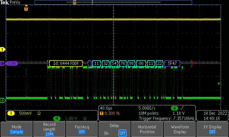

Here is perfect FDCAN packet send and acknowledged by other node:

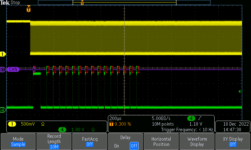

And here what happens if I try to Enable SAI2 MCLK
As you can see, my green waveform ( FDCAN) is jus garbadge. I can promise you where is no interference on PCB, they are located far far away from each other.
Any ideas?

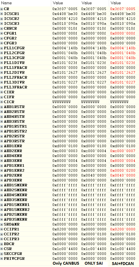

Read out and check/post content of relevant RCC registers.
‎2022-12-18 6:35 AM
Hello, Thank you for taking time on this:
Bits 25:24 FDCAN1SEL[1:0]: FDCAN1 kernel clock source selection
These bits are used to select the FDCAN1 kernel clock source.
00: HSE clock selected
01: PLL1“Q�? (pll1_q_ck) selected
10: PLL2 “P�? (pll2_p_ck) selected
11: reserved
CCIPR1 is set correctly in both cases:
AHB2NER are also looking ok
CCIPR2 looks to be correct also SAI2SEL bit.
And the rest looks to be same on all cases

It looks like only single bit is killing my CANBUS :relieved_face:
SAI2_Block_B->CR1 = SAI_xCR1_MCKEN;
SAI2 don't even need to be enabled for clock to be passed to GPIO pin (PC11), I get clock, but I don't get any canbus traffic to MCU.
If I pass this single bit flip, all is well,I can receive and transmit canbus, no problems....
