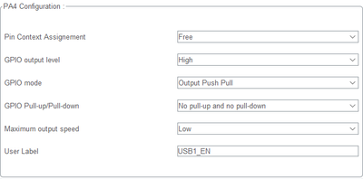

I'm trying to implement USB communication with a PC using USB1 (USB-C port) on an STM32N6570-DK with CubeMX. Most tutorials I've found on USBX are for older CubeMX versions and boards, so I'm a bit stuck.
When I connect the board to my PC, I only get Error Code 43 in Device Manager. Here's what I've done so far:
Enabled PA4 as shown in this diagram:

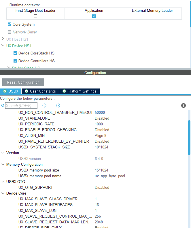

Enabled USB1 in CubeMX. Enabled interrupt and feft default settings otherwise:
Enabled USBX. System stack size: 10 * 1024, Memory pool size: 15 * 1024
Additional settings:

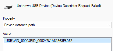

Device should show up in Windows Device Manager as:
Instead, I get this:

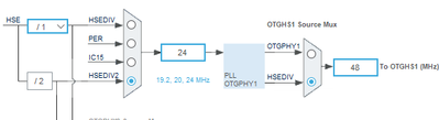

Changed clock configuration to 48 MHz.:

The status in Device Manager says "Device descriptor request failed".
VID 0000 and PID 0002 are not related to your device descriptors, this just means that the host cannot read the descriptors. A hardware USB sniffer would be helpful to understand why.

My solution was to change HAL_PCD_MspInit in stm32n6xx_hal_msp.c file to this:
  * @brief PCD MSP Initialization
  * This function configures the hardware resources used in this example
  * @PAram hpcd: PCD handle pointer
  * @retval None
void HAL_PCD_MspInit(PCD_HandleTypeDef* hpcd)
  RCC_PeriphCLKInitTypeDef PeriphClkInitStruct = {0};
  if(hpcd->Instance==USB1_OTG_HS)
    /* USER CODE BEGIN USB1_OTG_HS_MspInit 0 */
		__HAL_RCC_PWR_CLK_ENABLE();
	    /** Set USB OTG HS PHY1 Reference Clock Source */
	    PeriphClkInitStruct.PeriphClockSelection = RCC_PERIPHCLK_USBPHY1;
	    PeriphClkInitStruct.UsbPhy1ClockSelection = RCC_USBPHY1REFCLKSOURCE_HSE_DIRECT;
	    if (HAL_RCCEx_PeriphCLKConfig(&PeriphClkInitStruct) != HAL_OK)
	      /* Initialization Error */
	      Error_Handler();
    /* USER CODE END USB1_OTG_HS_MspInit 0 */
  /** Initializes the peripherals clock
    PeriphClkInitStruct.PeriphClockSelection = RCC_PERIPHCLK_USBOTGHS1;
    PeriphClkInitStruct.UsbOtgHs1ClockSelection = RCC_USBPHY1REFCLKSOURCE_HSE_DIRECT;
      Error_Handler();
    /* Enable VDDUSB */
    HAL_PWREx_EnableVddUSB();
    /* Peripheral clock enable */
    __HAL_RCC_USB1_OTG_HS_CLK_ENABLE();
    __HAL_RCC_USB1_OTG_HS_PHY_CLK_ENABLE();
    /* USB1_OTG_HS interrupt Init */
    HAL_NVIC_SetPriority(USB1_OTG_HS_IRQn, 2, 0);
    HAL_NVIC_EnableIRQ(USB1_OTG_HS_IRQn);
    /* USER CODE BEGIN USB1_OTG_HS_MspInit 1 */
    __HAL_RCC_GPIOA_CLK_ENABLE();
	LL_AHB5_GRP1_ForceReset(0x00800000);
	__HAL_RCC_USB1_OTG_HS_FORCE_RESET();
	__HAL_RCC_USB1_OTG_HS_PHY_FORCE_RESET();
	LL_RCC_HSE_SelectHSEDiv2AsDiv2Clock();
	LL_AHB5_GRP1_ReleaseReset(0x00800000);
	/* Required few clock cycles before accessing USB PHY Controller Registers */
	HAL_Delay(1);
	USB1_HS_PHYC->USBPHYC_CR &= ~(0x7 << 0x4);
	USB1_HS_PHYC->USBPHYC_CR |= (0x1 << 16) |
                                    (0x2 << 4)  |
                                    (0x1 << 2)  |
                                     0x1U;
	__HAL_RCC_USB1_OTG_HS_PHY_RELEASE_RESET();
	/* Required few clock cycles before Releasing Reset */
	HAL_Delay(1);
	__HAL_RCC_USB1_OTG_HS_RELEASE_RESET();
	/* Peripheral PHY clock enable */
    /* USER CODE END USB1_OTG_HS_MspInit 1 */
