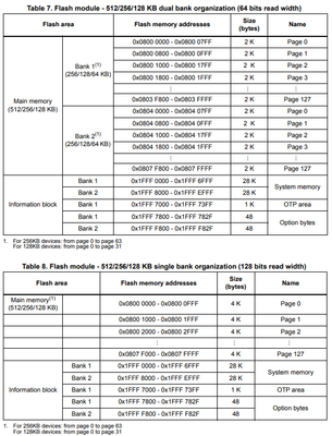

Mass erase is working with ST-Link Utility and with STM32CubeProgrammer. So Option Bytes are OK.
I think there is a bug with flashing procedure...
The linker script with 128K contiguous flash is valid for Single bank mode.
Yes, STM32CubeMx is missing the CCMSRAM.
For Dual bank mode, the upper 64K are after 0x08040000 (256K), and not 0x8100000.
Check Ref Man RM0440 for G4 series, table 7 Flash module for dual bank (table 8 for single bank mode).
But then, even if you have the right linker script, you must define sections to use this second flash Memory region.
And use this section in your code.

The linker script is not valid. It should have a flash length of 64K.
Optionally, it should have a second 64K region at 0x8100000. The two sections are not contiguous and there is no way to have them be treated as such by the linker.
Rgds,
Laurent
gjepali
In reference manual is this:
https://www.st.com/resource/en/reference_manual/rm0440-stm32g4-series-advanced-armbased-32bit-mcus-stmicroelectronics.pdf (site 96)
So if DBANK = 0, I could use all 128 kB flash. Addresses are consecutive without spaces (0x0800 0000 - 0x0807 FFFF for max capacity).
