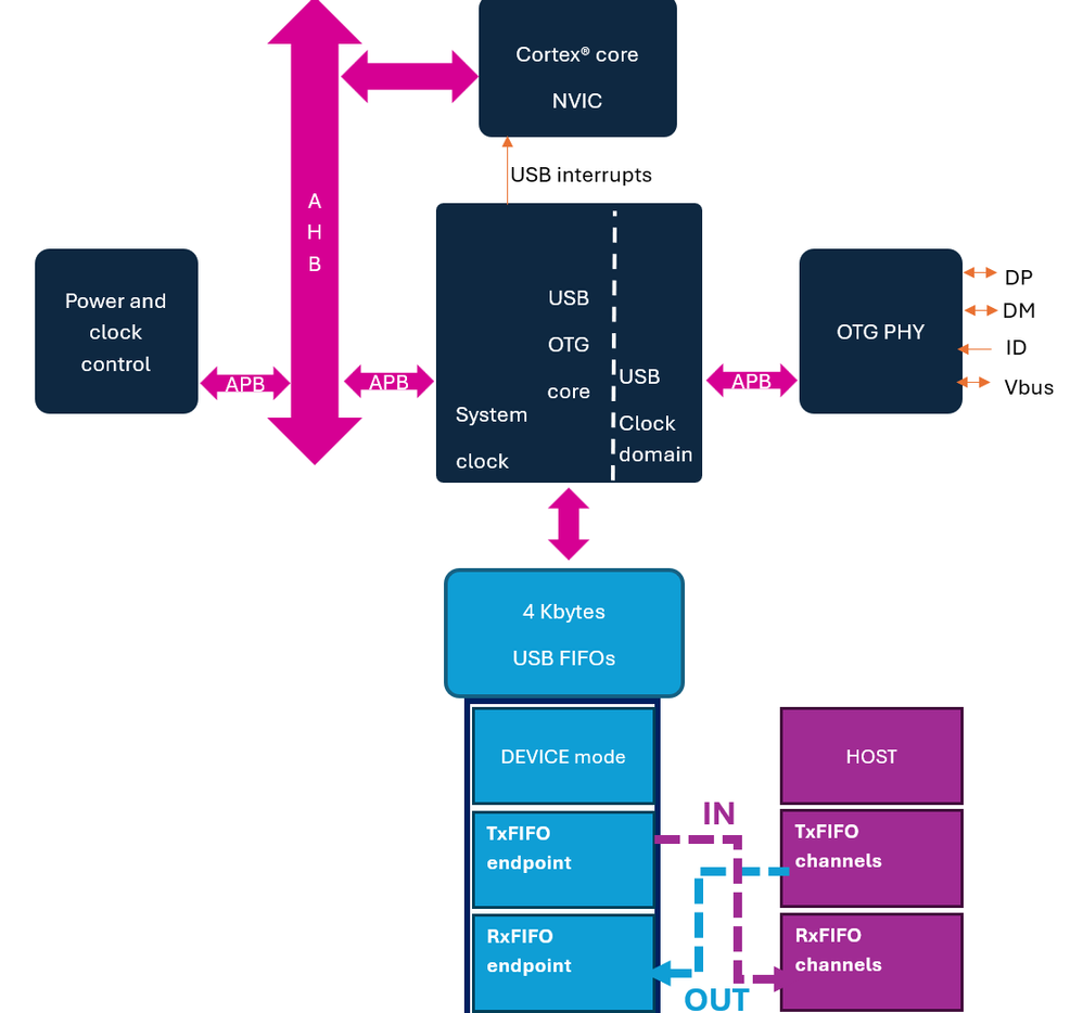

2. FIFO memory organization
The USB OTG controller module in STM32 devices organizes dedicated RAM into multiple Tx FIFOs for transmitting data and a shared Rx FIFO for receiving data.
Receive FIFO (RxFIFO) is used to store data received from the host. The size of the RxFIFO can be configured to optimize performance.
Transmit FIFO (TxFIFO) is used to store data that needs to be sent to the host. Each endpoint can have its own TxFIFO, and the size should be adjusted based on the type of data transfer (for example, bulk, interrupt, isochronous). The application pushes the data to be temporarily stored into this FIFO (in blue) before the USB transmission.

2.4 USB OTG controller operating modes
STM32 USB OTG controllers operate in different default modes depending on the controller type:
  • USB OTG_FS controller is configured in slave mode by default.
  • USB OTG_HS controller is configured in buffer DMA mode by default, but it can also be configured in FS and operate in slave mode.
These modes impact FIFO memory usage and configuration requirements, especially regarding additional FIFO space needed for DMA operations. This distinction is important when calculating FIFO sizes and setting up memory partitions.
