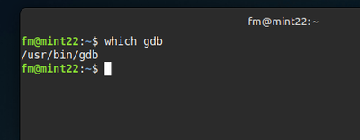

What does "which gdb" say ?
It should look somewhat like this:

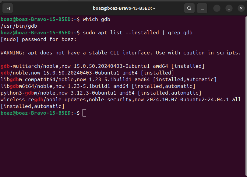

BTW, a check to see what is installed : sudo apt list --installed | grep gdb
This should give you a list of all installed packages containing the pattern "gdb" in their name.
You need sudo rights, obviously.

These are the packages for the host, i.e. x86 applications - not for the Arm Cortex cross toolchain.
You would need to do the same inside of the CubeIDE.
I'm no Cube user, but as Eclipse-based application, it should have an integrated terminal.
Try the "which gdb" there, followed by a "gdb --version".
IDEs like Eclipse or VS Code often install their tools in a "private" folder, and not system-wide.
Usually this is "/home/<user>/.<toolchain>/". Mind the dot in the name, I suppose you know what it means.
Subsequently, they point environment variables to their own tools, and use this environment for the build process.
However, the set of tools, their corresponding versions and the installation process is in ST's hands. In case of issues, they should suggest a remedy.
