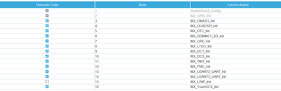

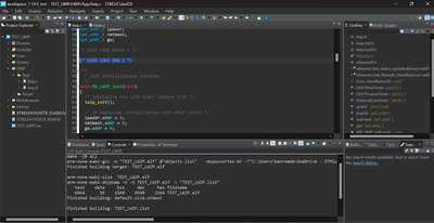

STM32CubeMX always generates the function MX_LWIP_Init even when its generation is disabled. This causes a redefinition during compilation if a custom implementation already exists. On every regeneration the autogenerated file re inserts the function and its prototype, triggering the conflict.

Attached a video with the problem. CubeMX updated to 6.15.

Further to the Screen Recording, I noticed that you added code line between
/* USER CODE BEGIN 2 */
/* USER CODE END 2 */
And after the generation, the part line placed between the /* USER CODE BEGIN  */ and /* USER CODE END */ is not being deleted.

Actually, it's not expected for the initialization code to be placed in main.c — in fact, CubeMX doesn't place any peripheral initialization code directly in main.c. Each peripheral has its own .c file where its respective MX_XXX_Init function is generated, such as MX_GPIO_Init in gpio.c, or MX_DMA2D_Init in dma2d.c. The only functions typically generated in main.c are SystemClock_Config and MPU_Config.
So in that sense, it's perfectly correct for the LWIP initialization to be placed in lwip.c.
Now, if you explicitly disable the generation of MX_LWIP_Init in CubeMX, then naturally that function should not be generated. Otherwise, what would be the point of having the option to disable it in the first place?
In my case, I’m placing my own initialization code in the only appropriate place available — between the /* USER CODE BEGIN */ and /* USER CODE END */ blocks. Based on all this, I still believe this is a bug.
I'd really appreciate it if you could try placing your own initialization function between the USER CODE blocks and let me know if it fails to compile due to a duplicate definition. If that’s the case, how are we supposed to add custom initialization code if CubeMX doesn't properly respect the option to not generate it?
