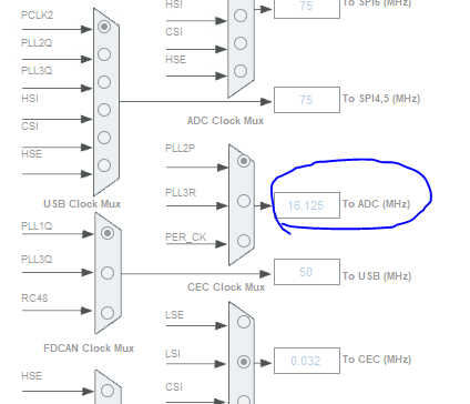

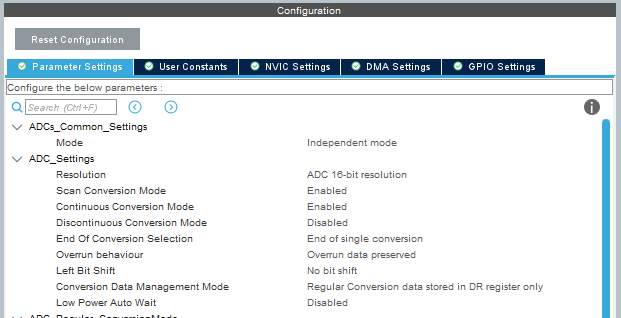

The said version seem to have missing ADC "Clock Prescaler" in the configuration menu and ADC clock generation is locked disabled in the "Clock Configuration" menu even when ADC is set enabled.
The issues are gone when downgraded to 6.4.0.
Please have a look on this issue.
Thank you
Board: Nucleo STM32H755ZI-Q
Firmware: STM32Cube FW_H7 V1.10.0
Image 1: No "Clock Prescaler" menu in the ADC configuration menu
0693W00000Kcvz2QAB.pngImage2: ADC clock configuration is locked disabled even when ADC1 is set enabled.

Sara BEN HADJ YAHYA
Hello @GOh.4​ ,
This issue is fixed in STM32CubeMX latest release.
V6.6.0 is now available under this Link.
Thanks for your contribution.
