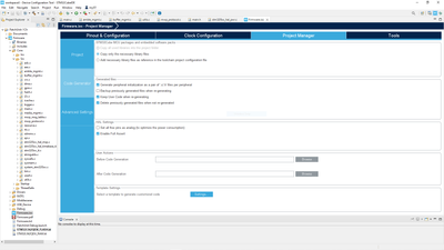

It would be very helpful if you share your .ioc file to investigate this issue.
Please share also the screenshots of the error message and the "Project manager" window of CubeMx.

There is a report file also, and that looks right.  The tool just didn't regenerate/update the source.
Screen shot:

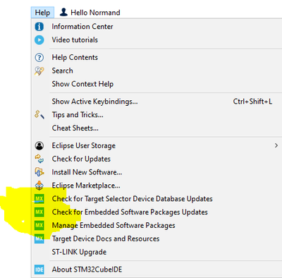

Grizz
Looks like maybe all the package updates did not get applied.
I manually went in and clicked Check for Target Selector updates and Check for embedded software package updates.  Once I did that and restarted CubeIDE, code generation began to run and completed successfully.
I suspect either a silent failure during the update OR the update caused some component mismatches which the update checks corrected.
Either way, it would have been nice to see an error message.  A sub-one second pop-up doesn't do it for me.
It works to me in 1.15.1 after update MCU Package with Manage Embedded Software Package.
