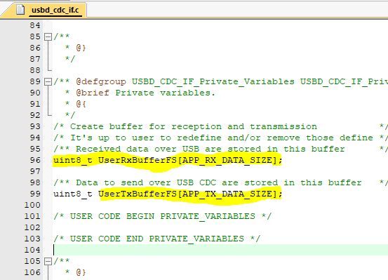

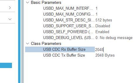

inside usbd_cdc_if.c the allocation of TX and RX buffer is on Stack and is 2048+2048= 0x00001000
So the Stack must be above 0x1400 (0x400 is the default stack alloc.)
As for the Heap allocation, follow the guide from ST.
Are you sure?
-- pa
Hi
Yes , this is a higher layer buffer allocated by user.
I put a Photo for this in the previous post. Very easy to check.
This buffer is different than in the first answer posted.
I know it seems irrelevant with this case but the uint8_t UserTxBufferFS[APP_TX_DATA_SIZE]; is on stack and as global, allocated first.

I still have the driver problem initially described.
I increased the size of the stack beyond 1400..3000 without result.
