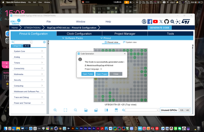

2025-01-21 1:01 AM - edited 2025-05-20 6:17 AM
Hello @chairdeng
I am happy to announce the issue was fixed in STM32CubeMX.
You just need to download the installer form st.com and make a fresh install of STM32CubeMX 6.14.0.
