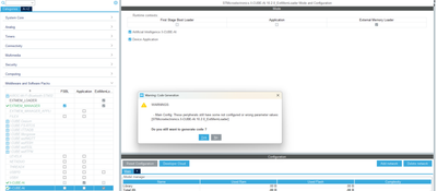

I'm having trouble getting the CubeMX code generation to work reliably with X-CUBE-AI package.
After first adding X-CUBE-AI to the project, and adding one of the models from the ST model zoo, i get this warning:
If i click Yes, the code generation takes about 5 minutes and works.
Note that in the above picture, X-CUBE-AI ExtMemLoader is selected. This is also where the warning comes from. AFAIK, i don't need X-CUBE-AI ExtMemLoader, just the Application. If i remove the checks from the checkboxes "Artificial Inteligence X-Cube-Ai" and "Device Appliccation", and then reopen MX, the X-CUBE-AI ExtMemLoader will disappear, and just the X-CUBE-AI Application remains. However, after trying to generate code with that setup, the code generation hangs to the below phase of code generation:

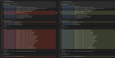

Also there are some paths in the mx-generated.cmake which are wrong i think, as the code fails to build:
[0/1] Re-running CMake...Build type: Debug
-- Configuring done (0.4s)
CMake Error at mx-generated.cmake:147 (target_sources):
Cannot find source file:
C:/Users/tuoma/STM32Cube/helium_test/Src/audio_network.c
Call Stack (most recent call first):
CMakeLists.txt:40 (include)
CMake Error at mx-generated.cmake:137 (target_sources):
C:/Users/tuoma/STM32Cube/helium_test/Middlewares/ST/AI/Npu/ll_aton/ecloader.c
CMake Error at mx-generated.cmake:136 (add_library):
No SOURCES given to target: ST
CMake Generate step failed. Build files cannot be regenerated correctly.
but builds after adjusting the paths:
and fixing missing include in generated app_x-cube-ai.c file
C:/Users/tuoma/STM32Cube/helium_test/CORTEX_HELIUM/Appli/Src/app_x-cube-ai.c:50:1: warning: return type defaults to 'int' [-Wimplicit-int]
50 | LL_ATON_DECLARE_NAMED_NN_INSTANCE_AND_INTERFACE()
C:/Users/tuoma/STM32Cube/helium_test/CORTEX_HELIUM/Appli/Src/app_x-cube-ai.c: In function 'LL_ATON_DECLARE_NAMED_NN_INSTANCE_AND_INTERFACE':
C:/Users/tuoma/STM32Cube/helium_test/CORTEX_HELIUM/Appli/Src/app_x-cube-ai.c:55:1: error: expected '=', ',', ';', 'asm' or '__attribute__' before '{' token
55 | {
The issue is that LL_ATON_DECLARE_NAMED_NN_INSTANCE_AND_INTERFACE is not found, but after adding
#include "ll_aton_rt_user_api.h" the project finally builds.

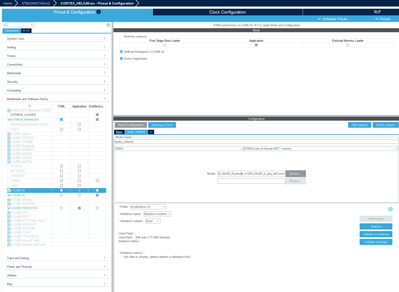

Here is the X-CUBE-AI Application config:
The model is from here https://github.com/STMicroelectronics/stm32ai-modelzoo/blob/main/audio_event_detection/yamnet/README.md

Hello @Tuomas95
In the Software pack Selector, it is mentioned that the External Memory Loader does not support Software pack, How did you enable the X-CUBE-AI ExtMemLoader?
Otherwise, let's try disable and re-enable X-Cube-AI and check please. Or can you try delete .stm32cubemx folder under \Users\<username> and check if the issue persists?

Tuomas95
Hello @Souhaib MAZHOUD ,
I'm not sure how it got enabled, i did not enable it with intention to do so at least. Now i cannot disable it from MX.
I removed everything related to X-CUBE-AI_ExtMemLoader from the .ioc file, but the generation still gets stuck to "Saving project settings...", even after deleting the .stm32cubemx folder under \Users\<username>.
