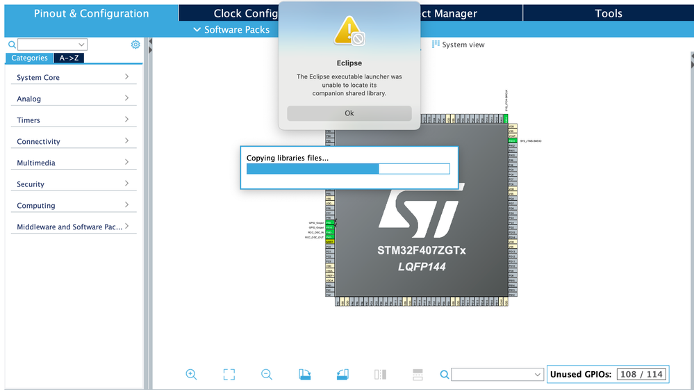

I have installed STM32 CubeMX on a Mac and I get the following error when trying to generate code:
The Eclipse executable launcher was unable to locate its companion shared library.截屏2024-12-01 18.42.46.png

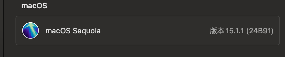

Hello @chairdeng
What version of macOS are you using?
KR,Souhaib

I encountered exactly the same issue. I’m trying to compile STM32 projects on a Mac using CubeMX and CLion, but every time I click “Generate Code” in CubeMX, it throws this error, causing CLion to fail to compile. It shows the message: “No project sources generated. Run Generate Code in CubeMX.” MacBook Air M1.

Hello @chairdeng @zuojaing
This could be an issue related to the unzipping of STM32CubeIDE.
Could you please try this command line that removes extended attributes in macOS:
xattr -c /Applications/STM32CubeIDE.app
KR, Souhaib
