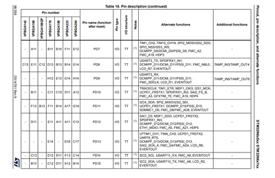

Possibly related: I noticed USART10_RX and USART10_TX are listed on the datasheet for PD14 and PD15. However they do not appear in STMCubeMX as options for those pins. It isn't clear if the problem is on the datasheet or on CubeMX

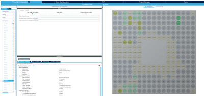

Hello @William6
Further to your comment and while enabling USART10 on STM32N647X0H3Q as Asynchronous Mode, you can notice that:
PD15 --> USART10_TX
PD14 --> USART10_RX.
Thanks.
