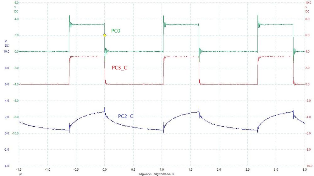

Hi Dave, Just back in the lab so thought I'd send the scope plot. This was just a simple toggle pin on the pins detailed. PC2 and PC3 should behave the same. As you can see they clearly do not!
I also noticed that most of ST's examples use Bank2 for SDRAM. Whether this is because of this issue or because they also demo other memory types who knows. Maybe both?
The register is SYSCFG->PMCR that cross links PC2 to PC2_C and PC3 to PC3_C (on H743zi at least.
This is what you are looking for.
Let me know what you find!
Mark
