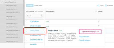

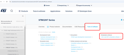

Now we know the family ...
Go to the 'Tools and Software' tab, click 'MCU and MPU embedded software':
You want the STM32CubeH7 pack:
The User Manual is on the software page, 'Documentation' tab:
https://www.st.com/en/embedded-software/stm32cubeh7.html#documentation
Don't know why that isn't directly linked from CubeMX - @STTwo-32 ?

See also the HAL documentation for the particular STM32 family - it will be linked from the Product Page for the family
joergk
"it will be linked from the Product Page for the family"
Where? On the website? Can not find it there.
https://www.st.com/en/microcontrollers-microprocessors/stm32h7-series.html
