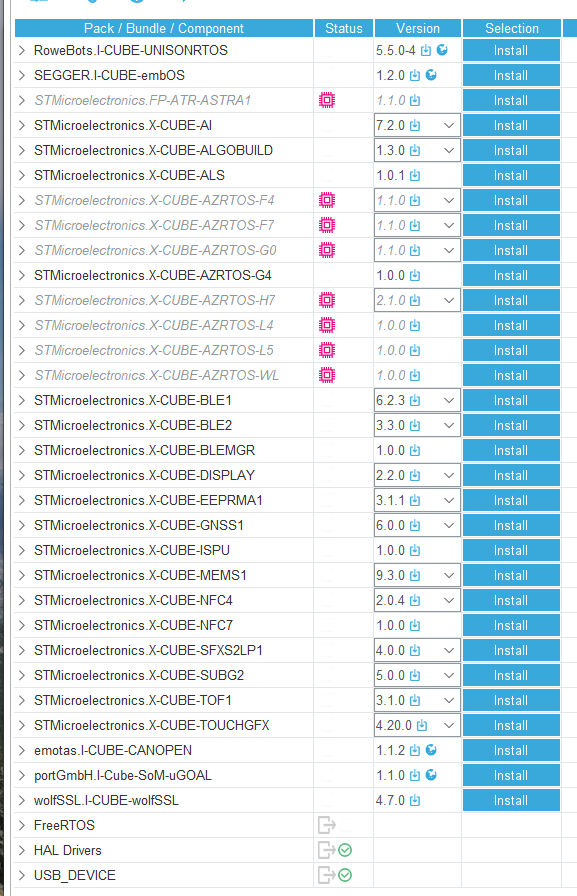

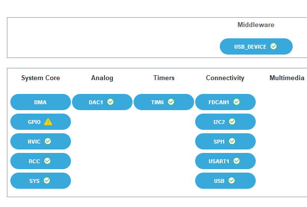

The CubeMX software packs I use:0693W00000SuBfxQAF.pngSelected features:
