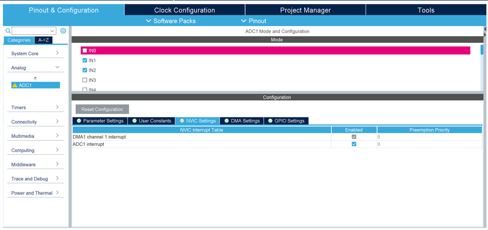

I am testing a STM32C0 MCU to see if it might be good for a project I'm working on attracted by the price point, but I have to say that I have some unexpected problem.
Among several the most relevant is multichannel DMA based ADC conversion that, no matter what I do, I can't have working.
The application runs the error callback at the first conversion start.
The ADC is in single conversion mode triggered by software and I have set a timer running every 50 milliseconds to run the conversion. I have also tried to connect the timer directly to the ADC to trigger automatically the conversion but the result is absolutely the same.
The system is running at 48MHz.
The conversion works correctly in interrupt mode on a single channel.
Can anyone help?

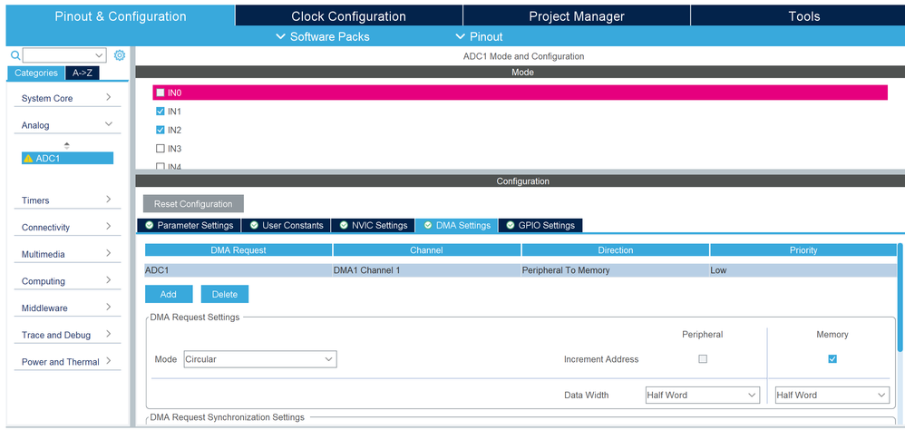

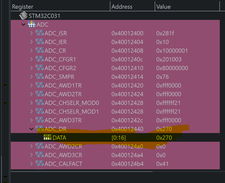

I managed to eliminate the fault at the start time so now I can run conversions but the array buffer adc_result is still not filled with any value. I checked into the registers and it seems to me that the ADC is working in fact fine. I can see the value of the last conversion inside the ADC_DR DATA register at every iteration changin while i move the potentiometer.

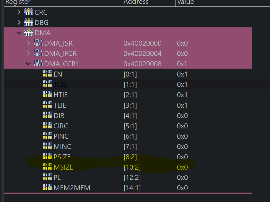

0693W00000aHFeYQAW.pngThen when I check the register of the DMA I see things that seem strange to me, for instance the MSIZE bits inside the CCR1 register should be 01 for half word size configured in the MX where i see 00.
Dont know it seems to me that it's a bit early for these C0 drivers....
MINC should be set, too.
Next step is to set a breakpoint at the beginning of function which sets up DMA and observe, why are those value set incorrectly.

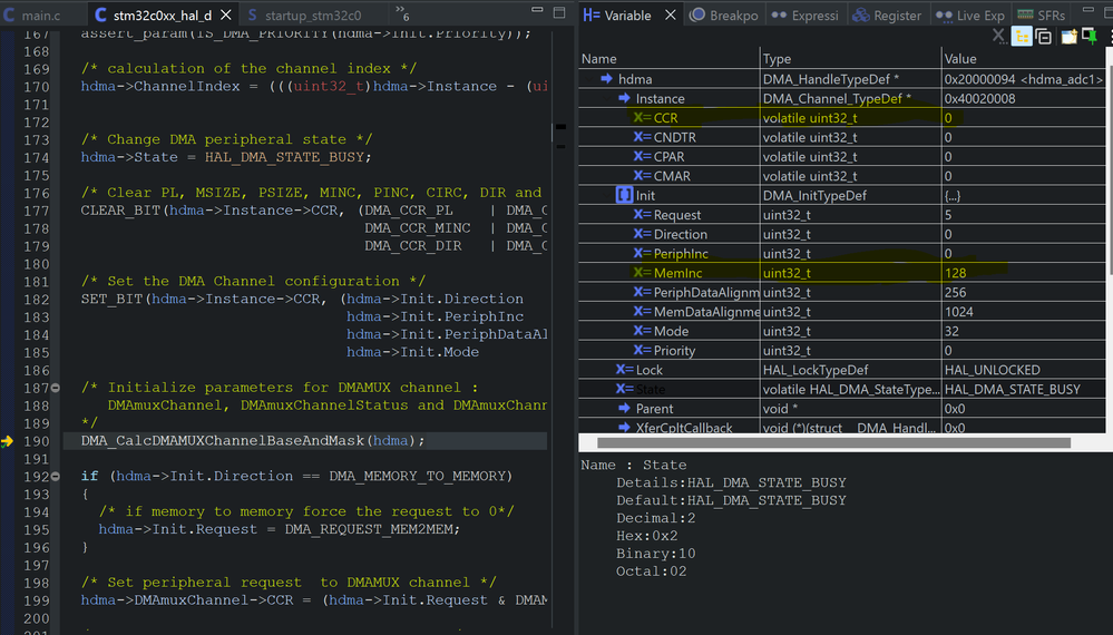

FCamp.1
I did at the DMA init function and what I see, for instance, is that the hdma structure contains correctly values, for instance MINC one... but after the BITSET the CCN register still remains completely empty.
I even try to execute a simple bitwise operation to set one single bit straight to the CCN register but again it stays empty. So my guess is that the issue is there, maybe the peripheral is simply off cause something goes wrong in setting up the clock or i don't know... here I stop cause it goes too deep in the st driver and I let them debug.
As said previously for me for the moment C0 is KO.
Cheers and thanks,
Filippo
waclawek.jan

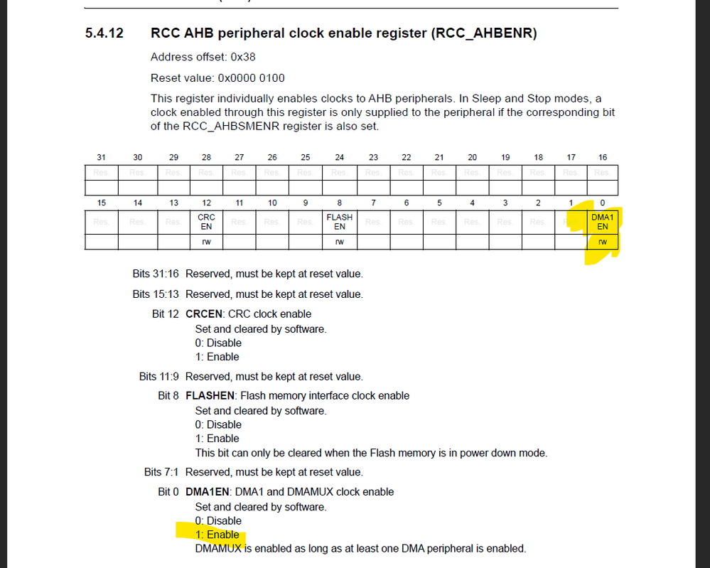

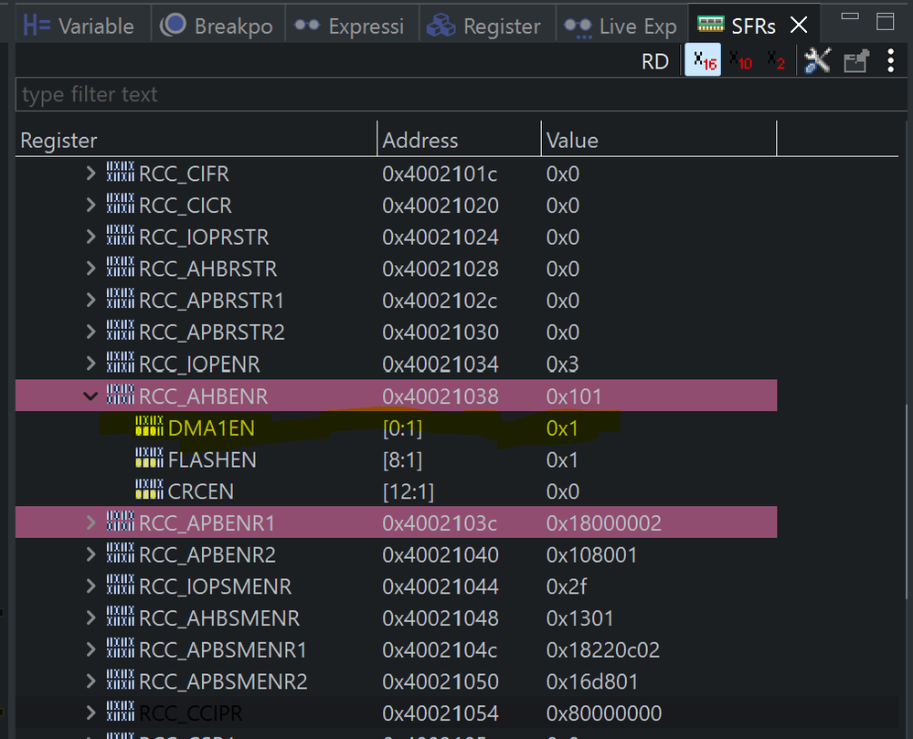

This typically happens if the DMA does not have enabled clocks in RCC. Check RCC registers content. Also you should see code to enable the DMA clock somewhere at the beginning of that initialization routine.
waclawek.jan
Isn't this another case of CubeMX improperly ordering the init functions?
Nope, the AHB enable register seems correctly set for DMA1

yep! you got it man!
Thanks so much!

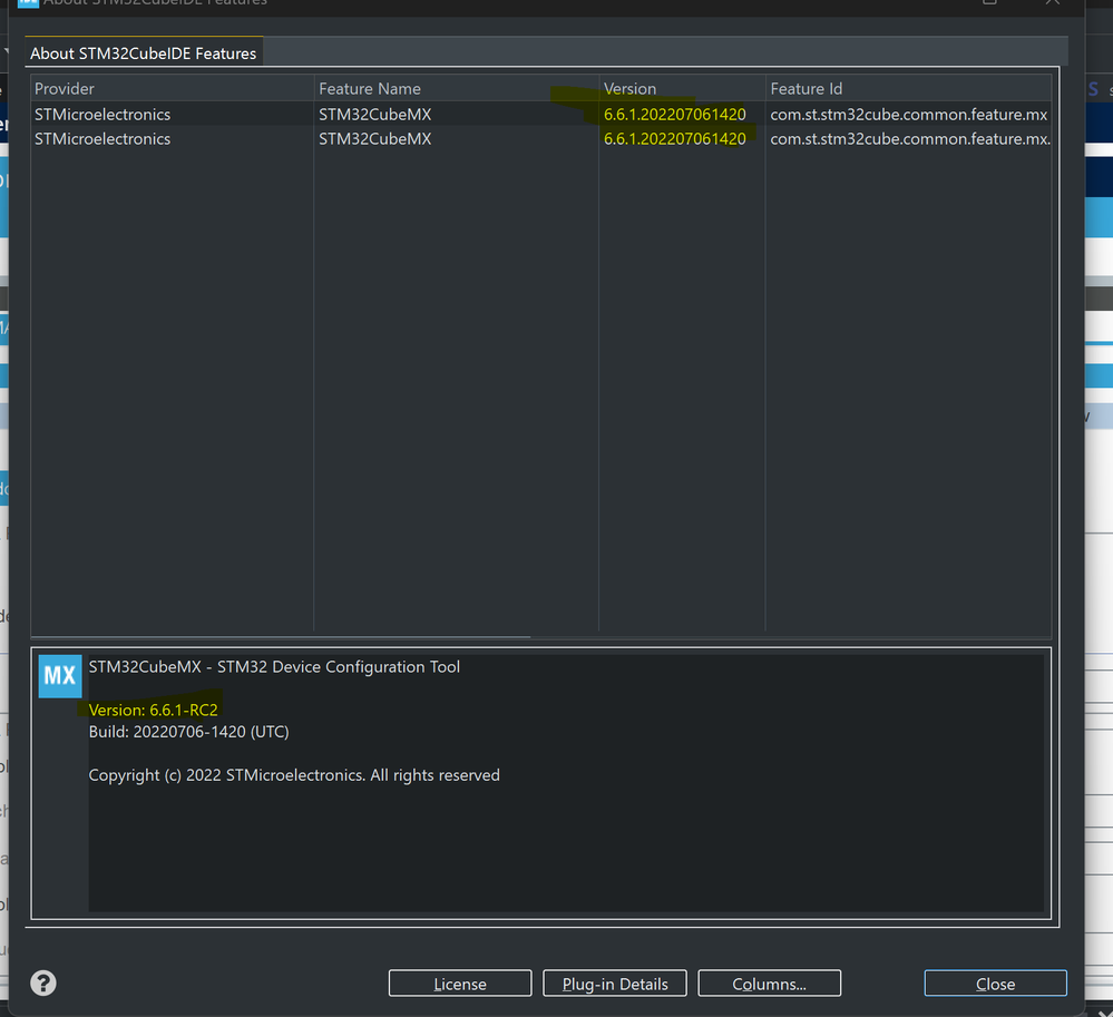

Only issue i have is that the post you linked is saying that he issue was fixed on version 6.4 of MX where I am at version 6.6... so clearly a vicious regression!
