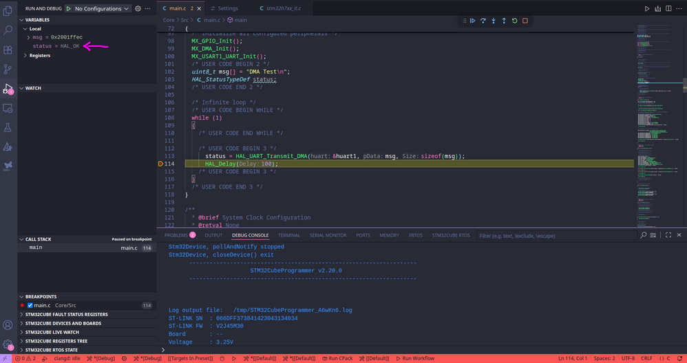

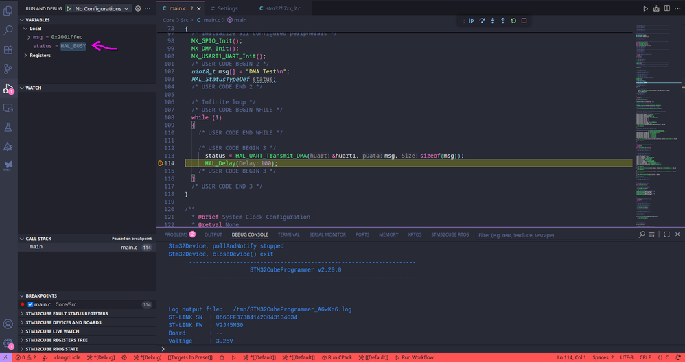

I have a problem with STM32 VSCode Extension v3.5.1 where the DMA on my STM32 H7 (STM32H725RGV6) doesnt work.
I tested this with UART TX and ADC Circular DMA mode.
The function HAL_UART_Transmit_DMA() returns HAL_OK at first, and then returns HAL_BUSY for the next calls. No data was transmitted at all recieved on the serial terminal.
UART and DMA blocking functions and with IT works fine.
The same setup with CubeIDE and with the older extension v2.5.1 works fine.
Any input is greatly appreciated.
Many thanks
Steps to replicate:
Start a new stm32 vscode project with STM32H7 like normal and enable uart1 (with all interrupts) and sw debug, max clock 550MHz with HSI.
call HAL_UART_Transmit_DMA() and it doesnt work :)

      status = HAL_UART_Transmit_DMA(&huart1, msg, sizeof(msg));
      HAL_Delay(100);

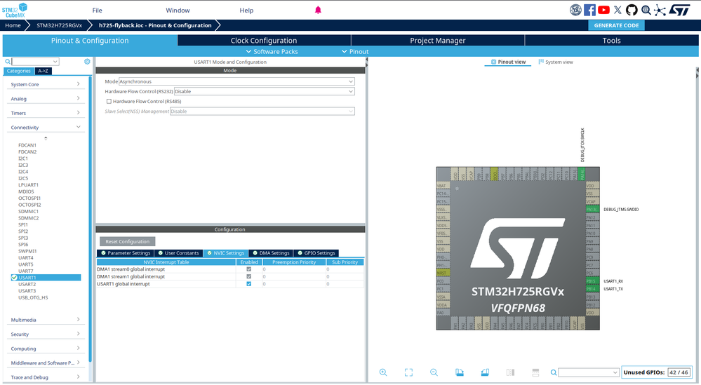

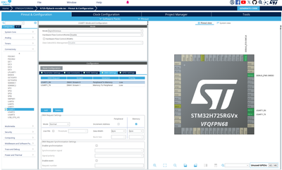

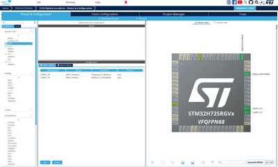

Hi @Nawres GHARBI ,
My bad, I forgot to remove the HAL_UART_TxCpltCallback() line. It was one of my attempts at debugging it.
Here are my DMA settings which should be the default settings when DMA is enabled.

A. NVIC Interrupt Priority and Enable
  • DMA1_Stream1 IRQ must be enabled and priority set (usually 0 or 1).
  • This is critical and often missed if you rely only on CubeMX generated code but then modify or migrate code manually.

Hi @Nawres GHARBI
Thanks for the reply, i have checked all the above and all of them have been done CubeMX but it DMA still doesnt work.
