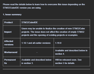

Recently, I received an email from ST recommending an update to the latest STM32CubeIDE v1.19.0 (screenshot attached). I updated my IDE as suggested.
Two days ago, I created a new project with ETH and HID enabled. During code generation, both the CubeMX version and the STM32Cube_FW package were updated to the latest versions. This replaced the middleware files and resulted in multiple syntactical errors (mainly in function arguments). Because of these changes, my customized code is no longer compatible, and the HID device is failing to be detected.
The major issue is that—even though the new project was created in a separate workspace—the old project in another workspace also got affected. The middleware files in that old project were automatically updated to the new version, even though I never regenerated code there. As a result, I have lost access to my original working code.

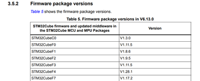

STM32CubeIDE 1.17.0 ( integrates CubeMX 6.13.0)  means you used to work with  the firmware version STM32Cube_FW_F7_V1.17.2 as specified in the release notes
First, check if this firmware is already present on your PC under C:\Users\<YourUsername>\STM32Cube\Repository. If it’s missing, download it from this LINK
extract the .zip file, and place the extracted folder (named exactly STM32Cube_FW_F7_V1.17.2) in the repository directory.
After that, open your project in STM32CubeIDE 1.19.0, open your .ioc file, and navigate to the Project Manager. Uncheck the option "Use latest available version," then select STM32Cube_FW_F7_V1.17.2 as the firmware version and generate your code.
