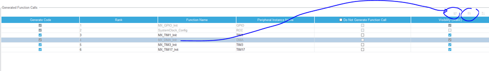

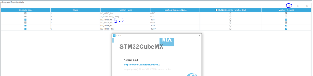

‎2023-03-01 9:26 AM
@Sara BEN HADJ YAHYA​ I got the same issue with cubeMx 6.6.1
I cannot change the order , for some reason DMa is greyed out and TIM1 cannot be moved neither
For the others TIM3 and TIM17 , i am able to change positions

‎2023-03-01 9:30 AM
Not for me, aparently if you migrated the cubeMX from older versions DMA's place in the Advanced Settings menu cannot be changed
‎2023-03-01 9:32 AM
I do the same, to manually override initialization of the DMA, but every time i click autogenerate it tends to switch them back to the wrong order, it gets very tyring after a while.
‎2023-03-01 10:15 AM
You can edit the ioc file manually with a text editor.
Just look at this line:
ProjectManager.functionlistsort=1-SystemClock_Config-RCC-false-HAL-false,2-MX_GPIO_Init-GPIO-false-HAL-true,3-MX_DMA_Init-DMA-false-HAL-true,4-MX_CAN1_Ini...
Here you can modify the order of initialization.
You can move the DMA init to position 3 (change the numbers with it).
From now on, the CubeMX will generate correct code.
