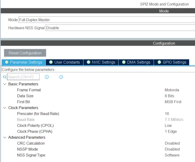

I am programing the STM32L4S9AII6 using the STM32L4R9I-EVAL board. My application requires the use of 5 different SPI buses, but the STM32L4S9AII6 only has 3 standard SPIs. However, it has 2 Octospi buses that I understand can be configured to be standard SPIs. Is this true or have I been mislead? Can someone shed some light on how to configure an Octospi as a standard full-duplex spi? Preferably using MxCube.
More specifically, I want it to be equivalent to this standard SPI configuration:

Full-duplex means transmit and receive simultaneously or: data exchange between master and slave.
That is *NOT* possible with OctoSPI (nor QuadSPI). These interfaces a specifially designed for merory accesses, where you've either a read or a write, never both simultaneously.

Okay, so lets say for some cases I don't care to read & write simultaneously. Is it possible to get it to behave like normal spi otherwise?

From the reference manual:
So can Octospi transmit/receive simultaneously or not?
You have hardware in front of you, you could test that for yourself surely?
My read of the documentation, diagrams, and supporting software is there isn't a TransmitReceive model here, the data phases are either Read OR Write, not both at once, the FIFO/DR plumbing similarly doesn't seem to accommodate that.
The Single-SPI SO/SI function is one of mapping pins/signals, these are the defined source/sink points, but no wording supporting that they operate concurrently. It's not going to fight data on the SI pin, and you could likely inspect the GPIO, or connect it elsewhere to capture.

I agree with you Tesla. I am at the lab bench to test this for myself, but I'm not making it far as the Octospi HAL API library supplies no such transmit & receive api call.

Just read RM0432, section 19.4.3. Instruction, address, alternate are "send to slave only", dummy is nothing at all, data is either "send to slave only" or "read from slave only" (depending on memory-mapped/indirect write or read).
The diagrams below are just for brevity, instead of showing two separate diagrams for both directions, they're combined into one. That's well-known and well-established convention, see e.g. datasheet of MC6821, Fig. 1 Bus timing as of 1985(!!!).
