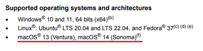

‎2024-10-21 1:56 AM
Hello @pkasbekar and sorry as I missed your reply,
@pkasbekar , @NullPointerException ,
Are you using these MacOS versions?
From STM32CubeMX V6.12.1 release note:
‎2024-10-26 4:42 PM
@mÆŽALLEm , .I am sorry for replying too late. macOS14.6.1 on Mac M2.
