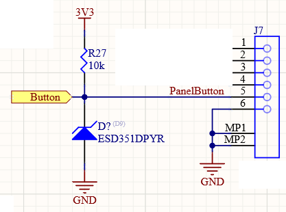

The schematic for that pin is very simple (one pull-up and a protection diode, Button is connected to PE2) :

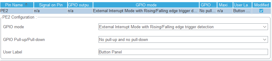

I am using STM32CubeMx to generate all the necessary code :
And I made sure to call the MX_GPIO_Init() function.

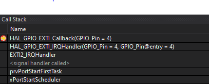

Right after calling the MX_GPIO_Init(), the EXTI2_IRQHandler is called over and over.

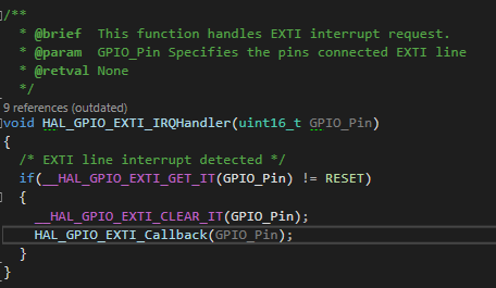

I also made sure that the interrupt is being cleared, this is done in the CubeMx generated code in the function HAL_GPIO_EXTI_IRQHandler :
The callstack looks like this :
I did not modify any of the CubeMx generated code, so the EXTI2_IRQHandler and HAL_GPIO_EXTI_IRQHandler are the default one.

Try to generate a pull-up on Cube MX.
Hope this help.
‎2020-04-20 9:08 AM
Hi and thank you for your answer.
I have tried that already and tried it again just to make sure, but it unfortunately is not helping.
If you have any other ideas :)!

‎2020-04-20 10:34 AM
Really sounds like hardware/layout issue.
Put the chip in reset (hold NRST low), and measure the voltage both with and without the button pressed.
There are only so many configuration options for GPIO pins, and none of them would make the pin float at 1.8V. The pullup/pulldowns are about 60kOhm, so would have much less influence than the external 10k pullup.

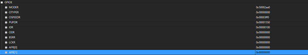

Read out and post content of GPIO registers.

Here is the status of the GPIOE when entering the HAL_GPIO_EXTI_Callback() function :

‎2020-04-21 3:24 AM
MODER for PE2 is 0b10 i.e. AF, and AFR[0] is 0, i.e. it's set to TRACECLK.
It oscillates, so you see a "mid-value" using a multimeter.
> As for as I know trace is not enabled :
Maybe the mechanism to enable it is somewhere else in your IDE than you've looked.
