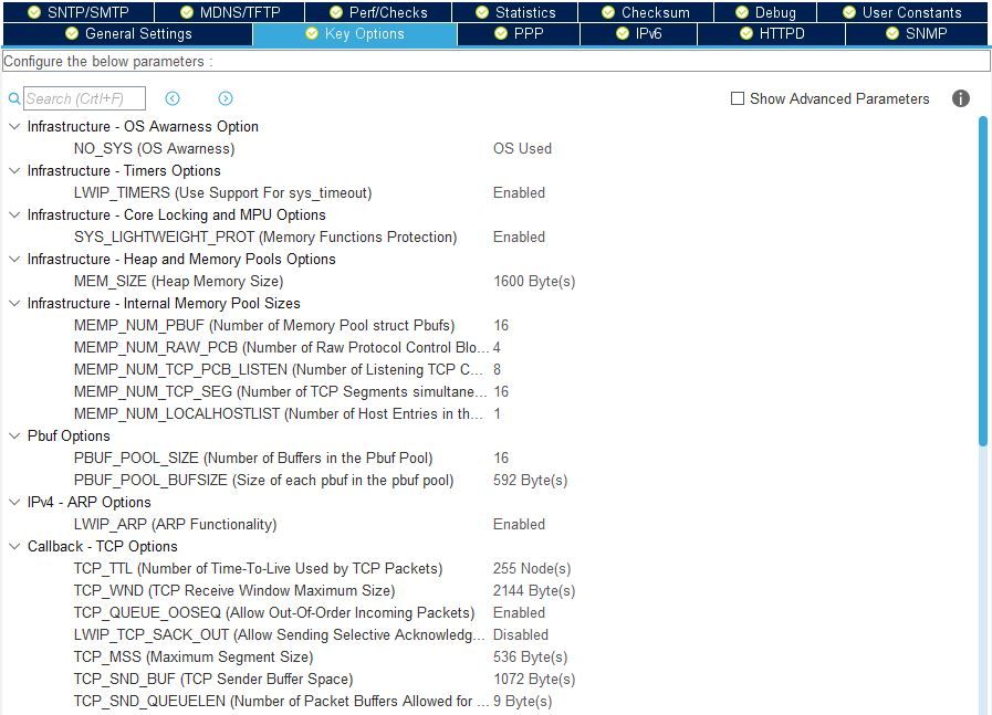

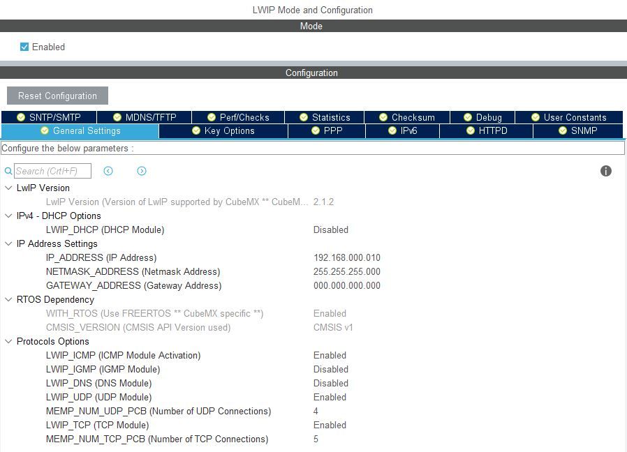

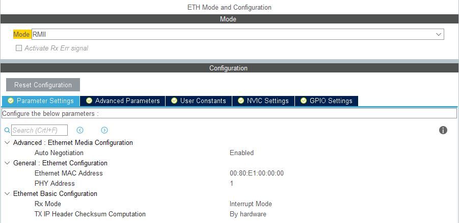

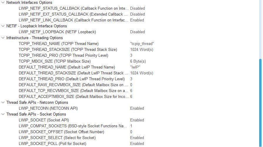

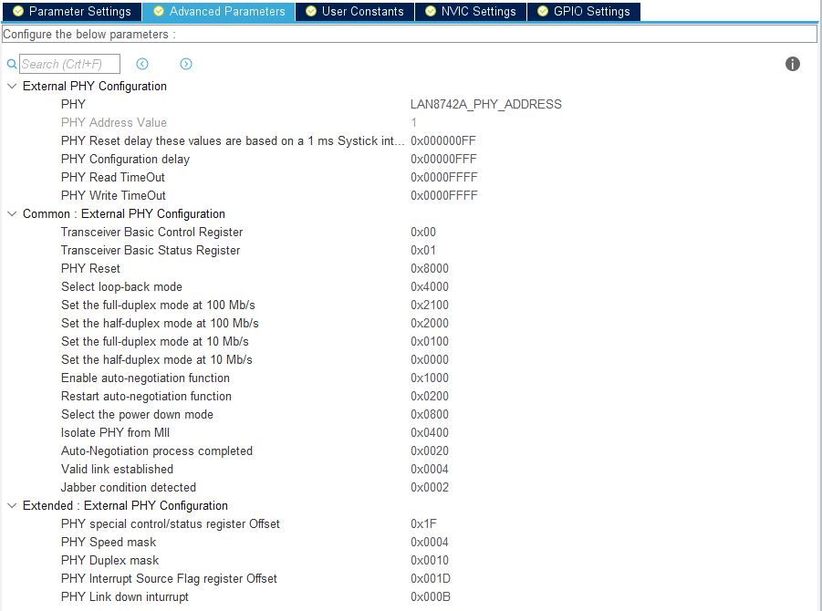

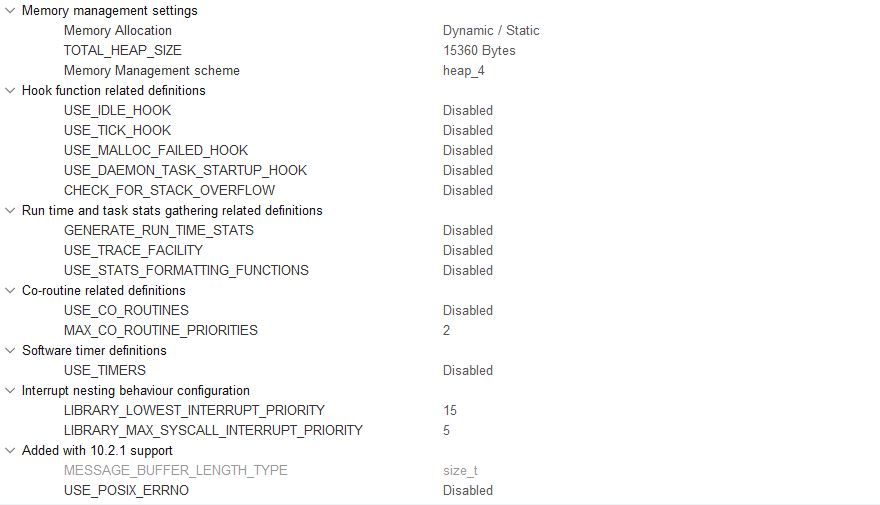

Hi all,

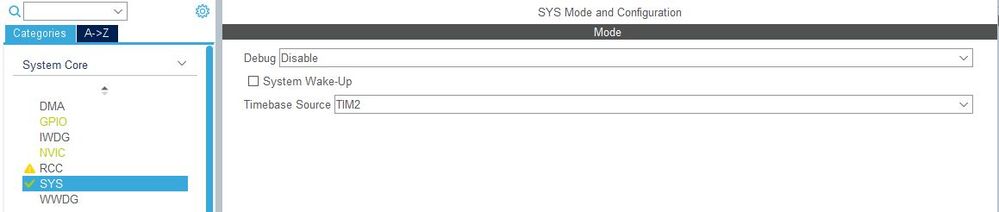

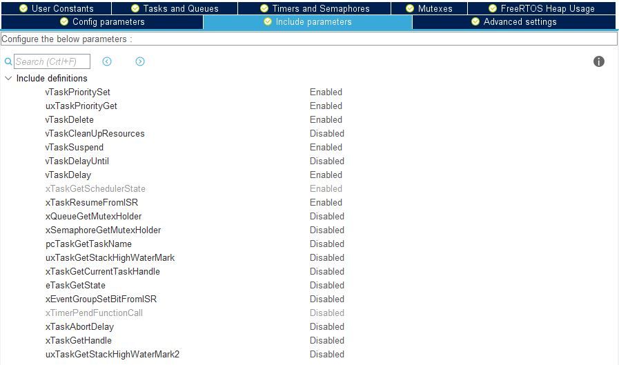

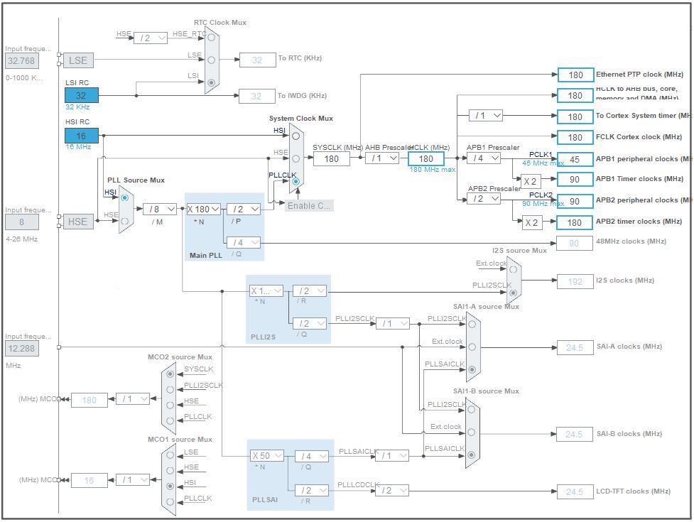

I'm trying to develop a simple tcp echo application with my NUCLEO-F439ZI. I used CubeMX to configure my board. My app is under FREERTOS using LwIP library. I followed example indications I found but It really doesn't work fine. This is the my CubeMX configuration:

When I debug, my code always go into static void prvCheckTasksWaitingTermination( void ) function.
Could you help me please? It took me forever.

‎2020-04-21 12:03 AM
Hi @AFara.2​ . What worked for me was to set "PHY Address = 0" , that would be in the third image that you posted. Otherwise, all other configuration was left with their defaults.
