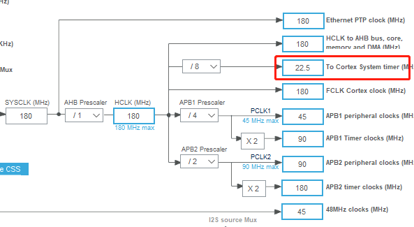

CubeMX bug??? the generated clock frequency of cortex system timer is not what I set in CubeMX
2022-05-07 1:38 AM

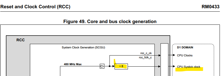

As showed in captures, the cloce source of cortex system timer is AHB/8 but not core clock and the frequency of systick is 22.5Mhz. However the generated clock source is Processor clock (AHB) not AHB/8.
Is this CUBEMX BUG ??
0x07=0111b
Bit 2 CLKSOURCE: Clock source selection
Selects the clock source.
0: AHB/8
1: Processor clock (AHB)

This is a known bug (systick divisor ignored, remains 1).
You can set the systick divisor manually.

@Khouloud OTHMAN Same issue with H743/753/750.
RM0433 shows the /8 divisor for systick, but I could not find it in RCC registers.
And no code for the divisor is generated.
CubeMX v 6.5.0, library H7 v 10.0
2022-05-10 1:46 PM
It's the SysTick_CTRL register bit CLKSOURCE. Look at PM0214 section 4.5.1. ARM's documentation is generic and it seems that PM0253 is less adapted for STM32...
2022-05-10 2:23 PM
Ah, so this is the "IMPLEMENTATION DEFINED external clock".
Then SysTick_Config() macro needs too much hacking.
Maybe the systick clock parameter should go to stm32...hal_conf.h along with TICK_INT_PRIORITY. Dunno.
