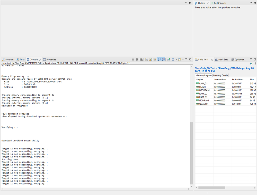

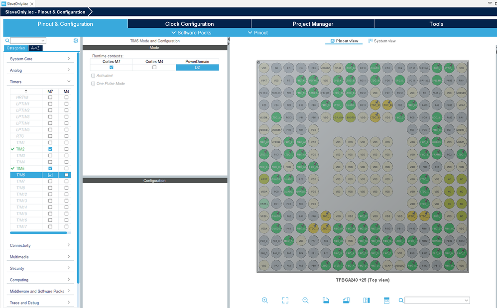

While enabling Timers in CubeMX, I accidentally clicked on TIM6 which is already on by default and used by the Core I believe. I re-enabled it by clicking on it again and of course the default settings got erased. And now whenever I try to run my code, it is giving me this error:
Target is not responding, retrying...
Question: How can I restore the TIM6 to its default settings so that I can solve this problem?
I compared the TIM6 settings with other working projects and couldn't find the difference. Other projects run on the board.

The "Target is not responding, retrying..." error message means that there is a communication problem between the board and the debugger. You need to consider and review a number of factors, like incorrect settings on the ST-Link, or wrong debug configuration, issue in debug pins assignment, USB connection issues...
First, try recover board with STM32CubeProgrammer: try connection under reset, or with BOOT0 pulled HIGH, might provide a quick way of recovery.
Check SMPS/LDO regulator issue. You can have a look at these articles that may help you:
- How can I recover my STM32H7 board after facing a power configuration deadlock?
- How to make sure the STM32 starts properly in our design?
