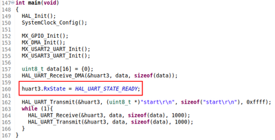

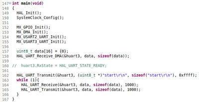

The below figure is the code I tested
I thought that if I called UART_Receive_DMA function in the code, the data only receive DMA method.

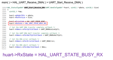

The reason is that UART_Start_Receive_DMA() called by HAL_UART_Receive_DMA() make receiver state (RxState) HAL_UART_STATE_BUSY_RX in line 3259 of second picture.

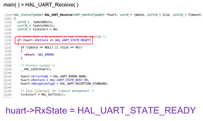

So when I called HAL_UART_Recevie() which does not use DMA method, HAL_UART_Recevie() cannot receive any data if HAL_UART_Receive_DMA() is already called before HAL_UART_Recevie().
This is because HAL_UART_Recevie() can receive data when receiver state is free (RxState == HAL_UART_STATE_READY) (below figure 1271 line)
So I thought that if user makes the RxState HAL_UART_STATE_READY after calling HAL_UART_Receive_DMA(), HAL_UART_Receive() could work (below figure)
I tested this code and result is weird.
When I give input string "Hello world!!" via serial communication to UART, UART cannot receive first character of the input string.
I think that the problem is HAL_UART_Receive_DMA() and HAL_UART_Receive() only check once receiver state (RxState) and both functions are ready to receive data.
So this code may make race condition between both functions.
I want to hear your opinion about this.

Mixing DMA and not DMA is not such a good idea.
Below a simple demo that sends data and reads data from another device such as a PC.
You can't have HAL_UART_Receive() and HAL_UART_Receive_DMA() working simultaneously. The peripheral has a single receive lane, and both of these functions use it. As you saw, the functions will return HAL_BUSY if one of them is already working.
This is nonsense. Forcing the state to reflect something else, just so a function returns HAL_OK, doesn't get around the underlying limitation of a single receive lane.
