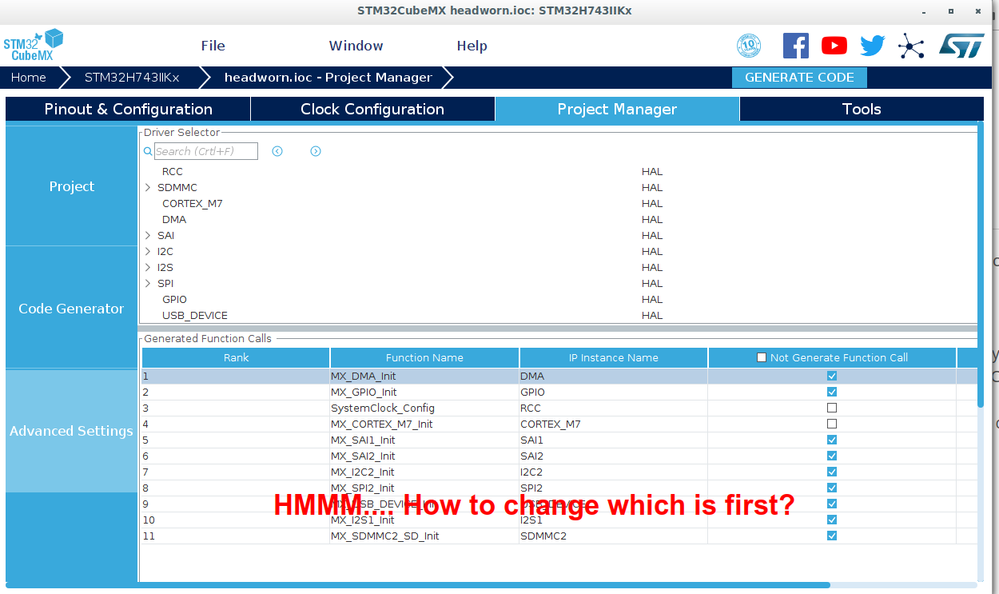

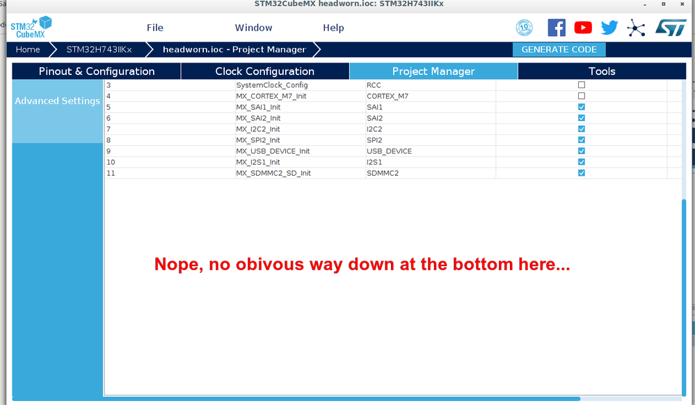

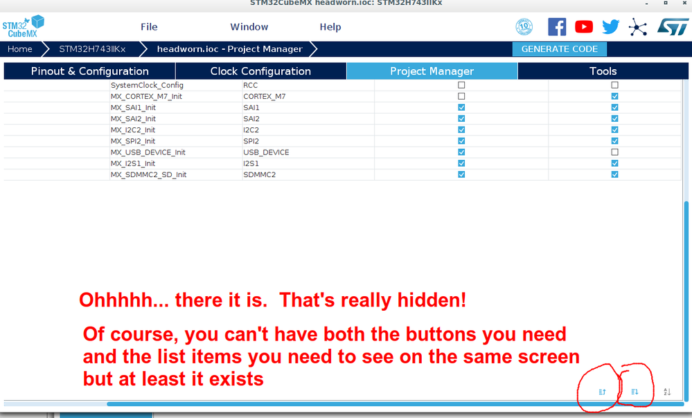

Ah! I found the secret, magic buttons that allow you to re-order the functions calls.
First of all, the tool should always put DMA first so that the generated code can work. However, you can, if you like, change the order of function calls by doing some magic-difficult-scrolling, finding the completely hidden buttons, and changing the ranking like this:
Maybe scroll down?
Oh wait... is that another, nearly invisible, scrollbar to scroll left and right? What about that?
