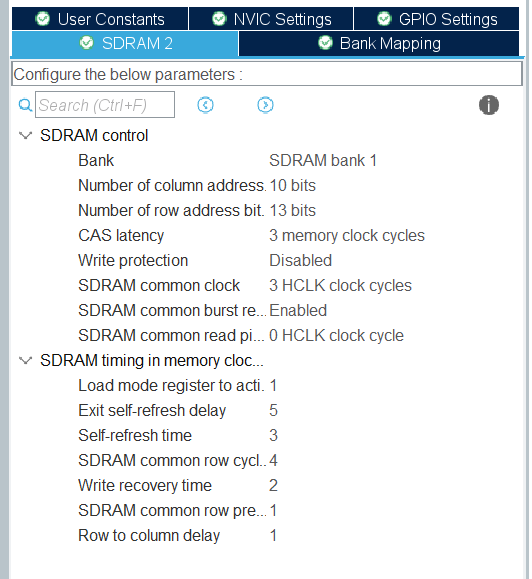

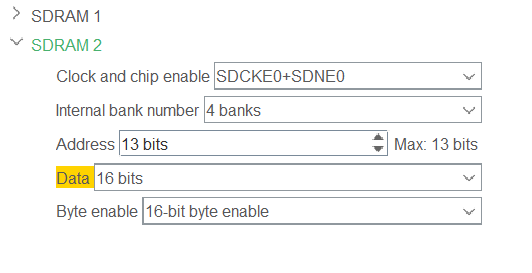

I am working with a new design which includes a STM32H7A3IGT6 with a connected SDRAM, IS42S16320F-7.
I've followed advice from this article:
https://community.st.com/s/article/How-to-set-up-the-FMC-peripheral-to-interface-with-the-SDRAM-IS42S16800F-6BLI-from-ISSI

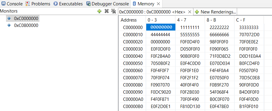

When I pause the program after initialization, I can use the memory viewer to view and modify memory at 0xC0000000 with no issues. However, when I hit any code that attempts to view or modify that same memory range I get a memory fault.
CFSR shows MMARVALID and DACCVIOL. MMFAR points to 0xC0000000.
Here is my configuration:

  /* Step 6: Set the refresh rate counter */
  /* Set the device refresh rate
  * COUNT = [(SDRAM self refresh time / number of row) x  SDRAM CLK] – 20*/
  result |= HAL_SDRAM_ProgramRefreshRate(hsdram, REFRESH_COUNT);
#define SDRAM_TIMEOUT                    ((uint32_t)0xFFFF)
#define REFRESH_COUNT                    ((uint32_t)400)   /* SDRAM refresh counter */
Any help would be appreciated. Thanks!
