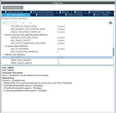

  • FREERTOS:
    •  user can configure the attributes of mutexes correctly (see screenshot below)
      Updating Media
    • Forced to 1 (Enabled) when - CMSIS_RTOS_V2 is used (constraint due to current cmsis_os2.c file in FW packs) - xTaskGetSchedulerState equals to 0 (Disabled) - xTimerPendFunctionCall equals to 1 (Enabled) - or xEventGroupSetBitFromISR equals to 1 (Enabled). As mentionned in Config parameter Tab.
