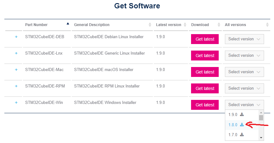

I didn't realise the CubeMX version was tied to the CubeIDE version (I was under the impression that you installed CubeMX separately). I've tried downloading en.st-stm32cubeide_1.8.0_11526_20211126_0815_x86_64.exe_v1.8.0.zip multiple times from the ST website but the file seems to be broken (7zip reports an error and Windows won't open the zip file either). Please can you ask someone to check this file please?

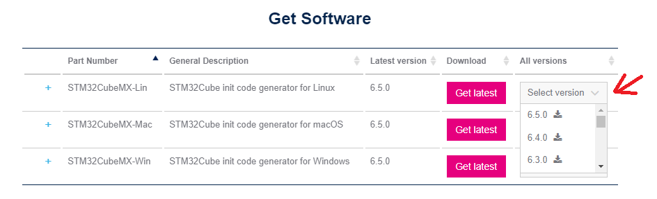

You can download CubeMx separetly from this link and generate code for CubeIDE. Go to "Select version" menu to download an older version:
You can open a new thread for the latest issue you reported.
Thank you for your understanding.

Thank you, I have Cube MX v6.4.0 installed separately now. If I wish to use CubeMX from within CubeIDE (which is how I have been using it so far) the downloaded file for v1.8.0 seems broken. Please can you check this file please?

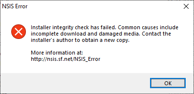

That's very odd, I've just redownloaded the V1.8 installer again and the zip file is still corrupt. If I extract the zip file using 7zip (Windows native zip handler refuses to open the file) and run the installer I receive a message telling me the installer integrity check has failed.

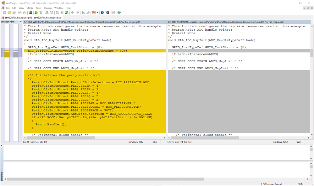

I have been fighting against the same problem for the last few weeks. At one point in time, the ADC clock was miraculously turned on in CubeMX. Instead of fighting another battle against CubeIDE/CubeMX installation, I saved the working version of the stm32h7xx_hal_msp.c and reused it over the new one created by CubeMX.
Attached are the diff screenshot and function code.

Following the advice of SofLit I'd downloaded V1.8 of the CubeIDE; the download now appears to now have been fixed.
