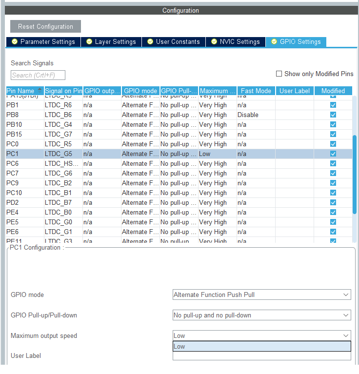

CubeMX doesn't let change the speed for the LTDC Pin PB11 to High, it only accepts "low",

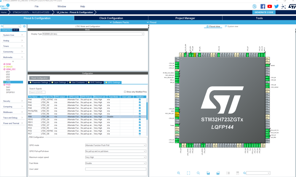

‎2020-10-29 2:56 AM
I opened your project, and I could change PB11 speed.
For ADC3 problem, I think it has been detected and will be corrected in next CubeMX version 6.1.0

‎2020-10-29 4:59 AM
Hi Mike,
thanks.
Regarding PB11: I have the problem when G5 is configured on PC1, moving it to PB11 solved it for me as well
