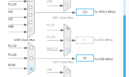

The clock "to ADC (MHz)" is grey in clock configuration. Don't see prescaler field in configuration. Plus it remove PLL **** configuration in main.c.

Since 6.5.0 (FW 1.10), all ADC's into the chip do not have their clock configured correctly.
With CubeMX 6.4.0 (FW 1.9), the To ADC was blue and ADC's clock were configured correctly.

Hi @GerHebert​ ,
You're right, the issue is reproduced and confirmed.
Actually, a regression was detected with the latest STM32CubeMX 6.5.0 version: Clock Prescaler parameter removal from the GUI and the non-activation of ADC Clock Mux although the ADC is configured.
As mentioned by @Amel NASRI​ , this misbehavior was already reported internally to be fixed as soon as possible.
