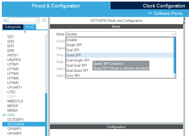

I have a ioc file created with Version 1.18.1, that enables only the OCTOSPI2 (and some RCC and clock settings).
Importing this file (see attachmend) the OCTOSPI2 gets disabled, further more it is non longer possibile to re-enable it as QUAD-SPI!
If added with out migration the IOC it is working as before.

I am having the same issue with a fresh STM32H23VETx project (CubeMX 6.15.0):

Also facing this issue with STM32CubeIDE 1.19.0 and am wondering if there's an update on this. I'd like to be able to use CubeMX code generation for this as opposed to manually configuring it. If not, did any of you find workarounds?

The problem seems to be resolved in STM32CubeMX 6.16.0 (together with STM32CubeIDE 2.0.2).
