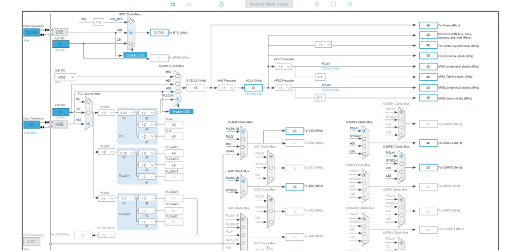

STM32L4R9 HAL_TIMEOUT in HAL_RCC_OscConfig
lukin
At code start-up, the function HAL_RCC_OscConfig return error HAL_TIMEOUT. I configured code with STM32CubeIDE. I am attaching clock configuration and code. Error is not repeatable, so it does not happen any time. Does anyone have an idea on how to solve it? Thank you.0693W00000Nre2jQAB.pngvoid SystemClock_Config(void)
Have your external clocks start more promptly?
Increase the timeout to something 10% longer than your worse-case bench testing of your design performance?
lukin
It happens even with board already powered up, for example while I am programming with st-link during normal development. Do you mean to add a HAL_Delay before run SystemClock_Config?
lukin
I noticed this behaviour once I set optimization to -og (for debug). It does not appear using -o0 (none optimization)
Well you do have ALL the source code, and the devices.
It's spinning on something coming ready, which doesn't, and perhaps the loop is poorly bounded, or its duration depends on optimization or code placement.
At the very least get the time it spins/dwells to be uniform and agnostic to the code optimization. Perhaps use a free running TIM2 or TIM5, or use the DWT's CYCCNT to count machine cycles.
