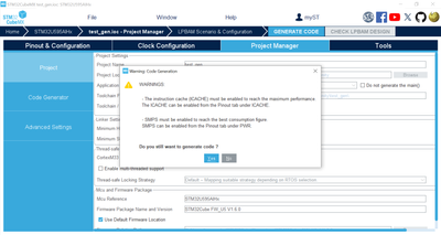

When using the .ioc to generate the code, it always shows:
- SMPS must be enabled to reach the best consumption figure.   SMPS can be enabled from the Pinout tab under PWR
How to get rid of this? Or just omit it?
STTwo-32
Hello @diverger
Is just a message that contain some tips that may help the user to reduce consumption or in other cases to make the code work more Fluently or.... If you are not using them, you just have to omit them. But you can't disable them. If you find this helpful, I've escalated your request (in the internal ticket number 187848) to the Cube team so they may consider this recommendation to disable/enable those pop-ups in the coming releases.

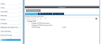

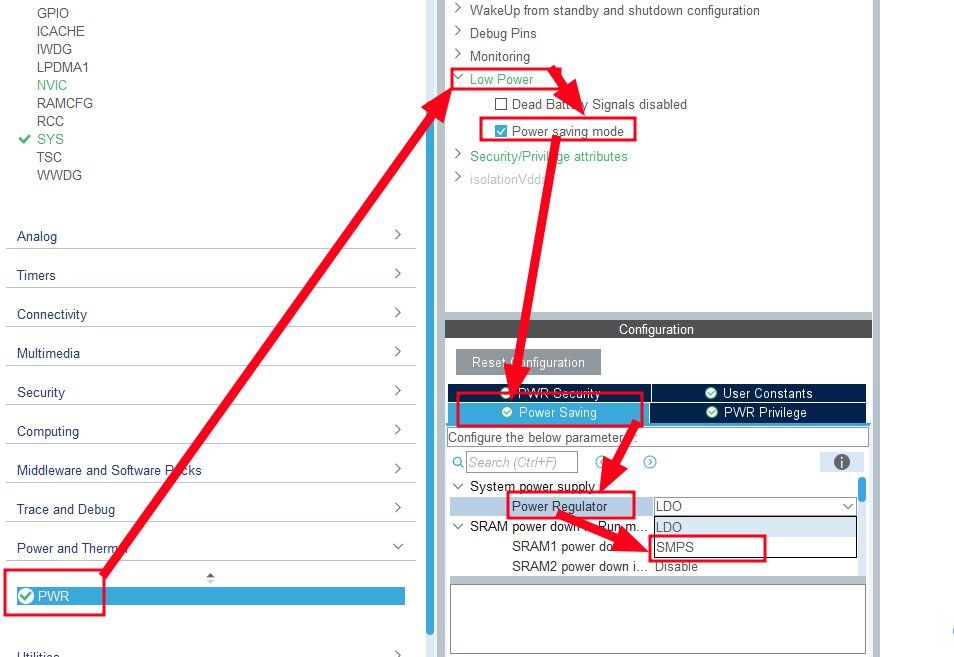

2. If the part does include an SMPS (part number includes a Q suffix), the UI buries the SMPS enable option 5 levels down:
Now that's some mighty terrible UX right there.
I've started this bug-report thread

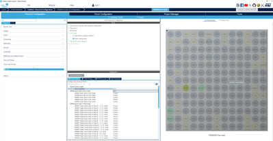

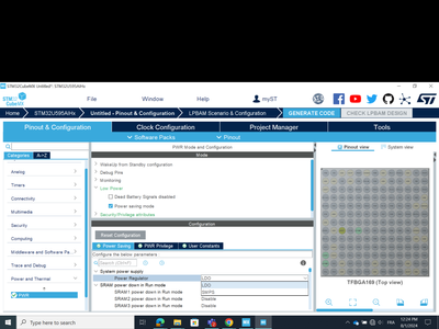

In System power supply, STM32CubeMX 6.9.2 gives the opportunity to choose between LDO and SMPS as power regulator in [ STM32U595xxxx] .
Knowing that STM32U595 MCU should not include SMPS and this issue was solved on STM32CubeMX 6.11.0.
The same topic has been mentioned through this Thread.
STM32CubeMX 6.9.2
STM32CubeMX 6.11.0
Thanks.
