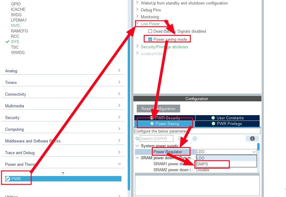

CubeMX hides "Enable SMPS" too well for STM32U5

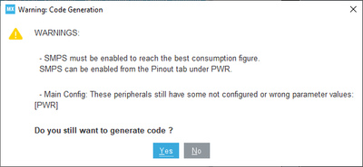

Cube is very enthusiastic about reminding you to enable the SMPS on U5 chips

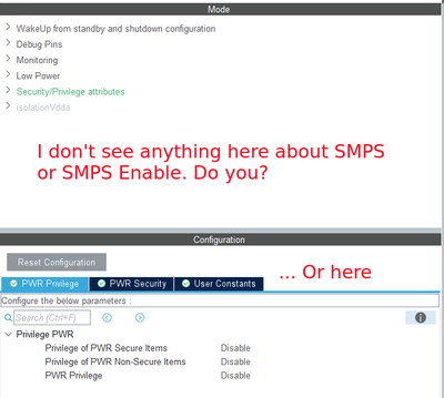

And it's also infuriatingly coy about how one actually does this:
Here is just the latest example of an understandably confused costumer.
I would like to see the warning message amended to give more specific instructions on how to do this,
(i.e. "enable low-power/power saving mode and then choose SMPS as the power regulator")
and the PWR pane should be modified to be more self-explanatory, either by reworking the options,
or the help strings, or both.
STTwo-32
STTwo-32Best answer
Dec 2, 2024 7:39 AM UTC
Hello @BarryWhit
The warning message on the new version of the STM32CubeMX (V6.13.0) came with the necessary details. For other feedback, you are always welcome to post on the ST Community.
Best Regards.

Also, I believe this is a known bug but if it isn't it should be fixed - Cube should not issue a warning about enabling the SMPS for part numbers that don't have an SMPS (obviously).
cc @STTwo-32 .

I thought I saw this for U575AGI6 on CubeIDE 1.14.1. But now when I try to create a new project with that Part number, I only get an error about PWR missing configuration. When I click on the PWR peripheral I just get a spinning wheel but no actual config pane for PWR shows up. So, I'm not sure what's going on.
I can't reproduce the issue (either the warning or the missing pane) on 1.16.0 though. My apologies.

As @Mahmoud Ben Romdhane mentioned in the other thread, I see that even with latest CubeIDE 1.6.0, for U595 parts (in particular STM32U595AIH6) which don't have an integrated SMPS you get the SMPS warning, and I'm also unable to open the PWR peripheral for configuration in the UI.
He also also informed this has been previously reported in
https://community.st.com/t5/stm32cubemx-mcus/stm32u5-invalid-smps-warning-during-code-generation/m-p/607336
and the third issue of the SMPS being available for selection for LDO-only parts was tracked and fixed via ID166485
The erroneous warning bug is possibly being internally tracked via ticket ID166502?
