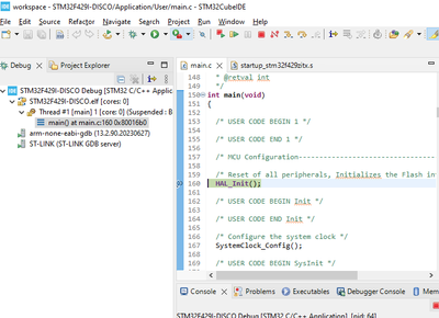

ah yes, so there is this one, another was the reset vector
Hello ferro,
look at your screen shot.
Do you open the "startup_stm_32f429zitx.s" file by your self?
Or opened it the IDE by magic?
Thats we are talking about....
remove the breakpiont at main and it open the file nevertheless.
an if you stop debung and run->debug again, mostly it opens an other file.

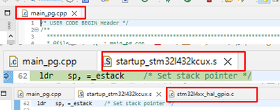

Ok 3 times test.
at first i has the main_pg.cpp then i get the .s and after this i get the .c
 I only  Run->Debug and stop it and run->debug again.
there is no edit or change on the source files
After 2 hits more
And this is random.
