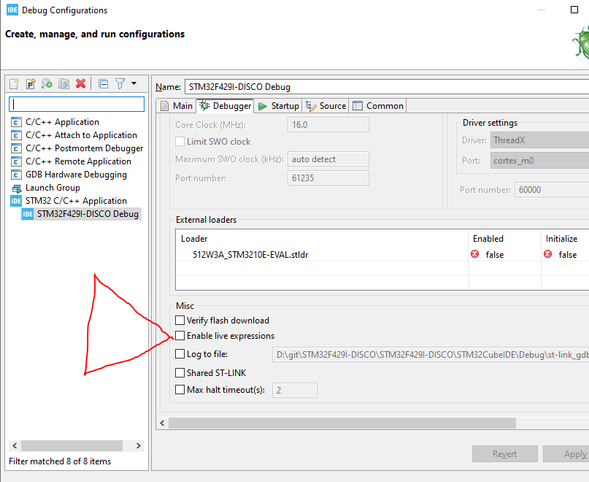

Try untick the 'Enable live expressions'
This prevented opening the startup_stm32xxx.s.
Sorry, but it doesn't work. Tested, the startup file still opens.
Thanks for checking. I can control opening startup with that option.

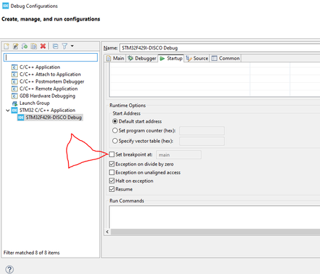

Second option I can force startup to (not) open is this
Untick [Set breakpoint at]

Great investigative work. Is it safe to conclude there is a bug in setting the breakpoint automatically at main?

Sorry, but no, close but not quite. The issue isn't that it sets an automatic breakpoint in main if you've selected that in the startup configuration, the problem is setting any breakpoint. That is, if you have no breakpoints set and don't have that option enabled, there's no issue. But if you set even a single breakpoint anywhere or enable that startup configuration one, then the startup.s file opens automatically.
"Is it safe to conclude there is a bug in setting the breakpoint automatically at main?"
Hm, not sure what it is.Uninvetable Side-effect?
Debug server needs MCU core to set up parameters user asks from it. Some of requested action from the server must happen even before flashing user SW. And DebugServer therefore calls startup.s. This is my theory confirmed by CubeIDE behaviour when try-error changing its settings.
And it seems that we know how to stop that startup.s to open. Maybe unfortunate default CubeIDE settings. Not sure.
[Edit] Seems I was too fast, does not work according to @AAlis.23 . Back to square one.
