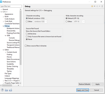

i found my post/sulution
padawan
Senior II
This points to the an other adress.
We are talking about the .s file in your screenshot on the right.
my setting
and it jumps.....

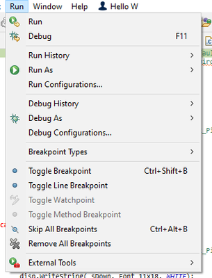

No i end the debugseesion  by hittung the red square.
If i edit a file, compile and hit debug again (F11)
it jumps

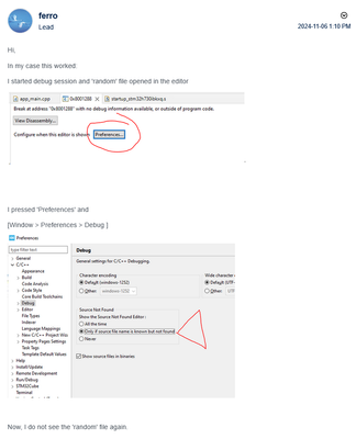

This solution only prevents non-existent source files from being opened. The s-file or some other files do open frequently.
Kudo posts if you have the same problem and kudo replies if the solution works.
Click "Accept as Solution" if a reply solved your problem. If no solution was posted please answer with your own.
Hello unsigned_char_array
yes i know.
this was/should be a reply for ferro, to show him, that his solution have nothing,
to do with the bug, we are talking about over 5 years.
