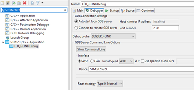

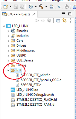

I would like to know How to configure the J-LINK Segger to work with STM32CubeIDE, after a little searching I found this video : https://www.youtube.com/watch?v=Rf-NKOoPYUc
But at 12:11 I can see this configuration in the video
But I don't have an Application directory :
In this case, do you have an idea how to do it ? Thank you for your helps.
Regards

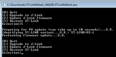

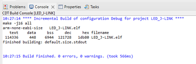

It's not the same, at the beginning I converted to J-LINK so I don't know if it's the same configuration :
Now I have an folder and no errors when compiling.

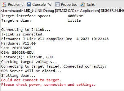

Now my errors is at the end to validate the operation. Now I try to connect
Now when I go into DEBUG mode there is an error, for me it is actually a hardware problem now since when compiling, I compile well with the J-LINK tool.
So do you have any idea now ?
@Andrew Neil wrote:

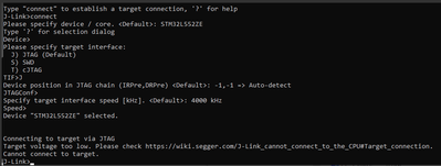

This error message:
tells you that it's the basic SWD hardware connection that's failing - it hasn't got as far as anything to do with RTT at that point!
Yes you're right but I have already configured the tool now I will check again to see what it gives. After checking nothing is works
that I try to connect via SWD or JTAG nothing works, so it is normal that STM32CubeMX cannot communicate with the J-LINK

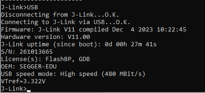

I don't see your video link but one thing what I am certain is that the connector is compatible with the evaluation card. When I connect with J-LINK and USB_STLK :
Now when I need to only with J-LINK for program and Debug (without USB_STLK) I have this picture :

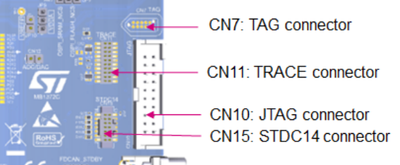

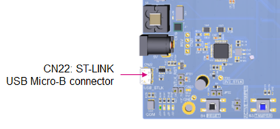

On my EV board first after I can switch to my real board. "USB_STLK" look on the evaluation card where the connector is located "USB_STLK"
OK, so that's CN22 - the micro-USB for the on-board ST-Link.
and you're connecting your JLink-EDU to the CN10 JTAG connector:
Yes?
So you're using CN22 to power the board:
