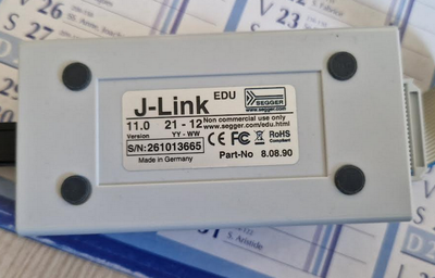

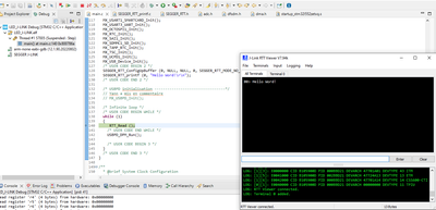

I would like to know How to configure the J-LINK Segger to work with STM32CubeIDE, after a little searching I found this video : https://www.youtube.com/watch?v=Rf-NKOoPYUc
But at 12:11 I can see this configuration in the video

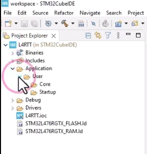

But I don't have an Application directory :
In this case, do you have an idea how to do it ? Thank you for your helps.

So how to find
How to switch to an equivalent of this window ? I think the STM32CubeIDE is the old version.

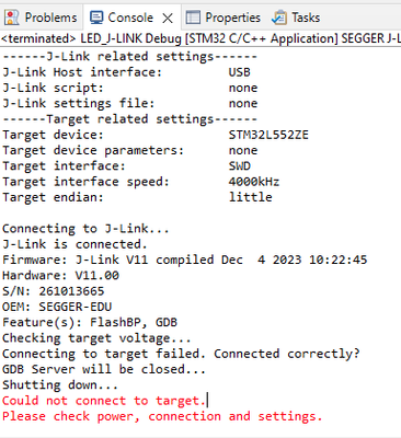

Your video is about how to set up RTT -  a Segger proprietary feature which works over the basic SWD hardware connection.
This error message:
tells you that it's the basic SWD hardware connection that's failing - it hasn't got as far as anything to do with RTT at that point!

This error message:
Yes you're right but I have already configured the tool now I will check again to see what it gives. After checking nothing is works
that I try to connect via SWD or JTAG nothing works, so it is normal that STM32CubeMX cannot communicate with the J-LINK
So this is not about the tool configuration - it is a basic hardware problem:
Are you also going to complain to Segger about giving you "useless" (sic) links?
When the basic hardware connection is not working, nothing which needs to use that connection can work!
