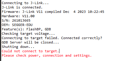

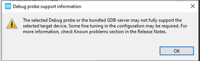

Again, the folder structure of the project doesn't have any effect at all on the debugger connection.
So having (or not having) an 'Application' folder won't solve this:
Or this:

The "Could not connect to target" definitely has nothing to do with the folder structure:  this is about establishing the basic connection between the debug probe and the target hardware.

Just as @Andrew Neil has mentioned, the folder structure has nothing to do with J-Link not able to connect to the target. It's a hardware connection issue. Double check your connections. Draw schematic on how you've connected the J-Link to the target device.

Your video is about how to set up RTT -  a Segger proprietary feature which works over the basic SWD hardware connection.
This error message:
tells you that it's the basic SWD hardware connection that's failing - it hasn't got as far as anything to do with RTT at that point!

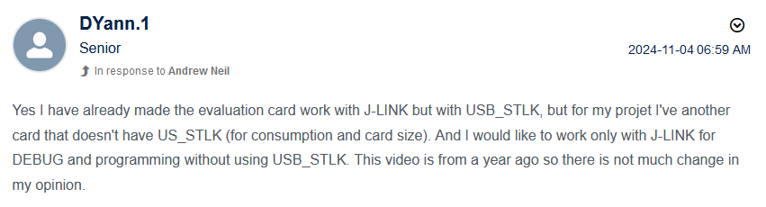

Yes I have already made the evaluation card work with J-LINK but with USB_STLK, but for my projet I've another card that doesn't have US_STLK (for consumption and card size).
So which one is giving the connection error - the EV board, or your custom board?
