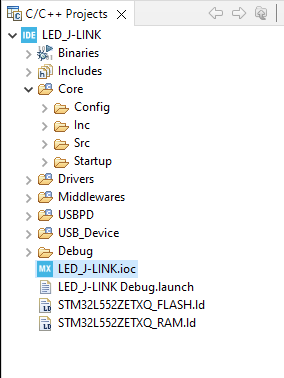

But I don't have an Application directory :
In this case, do you have an idea how to do it ? Thank you for your helps.

I have this picture and I don't have the Application directory
where did you see the Application directory ?
Sorry - you asked about a window - not a directory.
It's entirely up to you how you name and structure your folders - it does not affect the configuration of your debug probe (whether it's a J-Link or an ST-Link).
That is the default folder structure that CubeIDE creates.
Here is a description of what is in each of those folders:

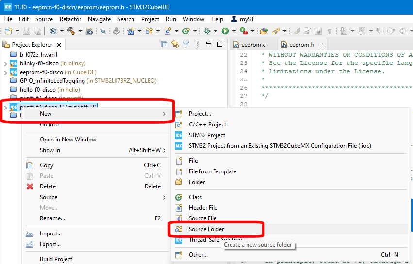

In that example, I called my folder "common" - you could call yours "Application", if you wish.
To add a custom folder, right-click the Project name, choose 'New', then choose 'Source Folder'
Note that you need to choose 'Source Folder' if it's going to contain source files that you want to be included in the build.
For other files (that will not be built), you can use the plain 'Folder' option.
