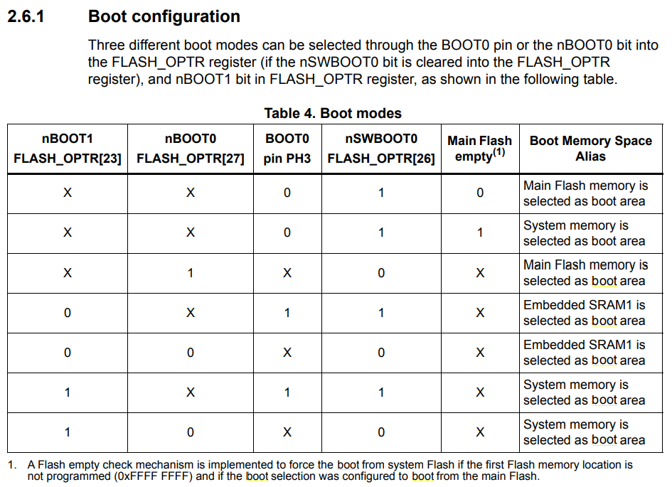

My issue is that when attempting to debug the MCU in STM32CubeIDE, it often attempts to start at address 0x1fff51F4 with the message "Break at address "0x1fff51f4" with no debug information available, or outside program code". main() is never called because my breakpoint at the top of main() is never hit. To mitigate the issue, I simply press the red "Terminate" button to stop the debug session, then press the "Debug" button to restart, and the program then loads at the correct address and breaks in main(). This happens randomly without any changes to the code, option bytes, or hardware. Yesterday it was happening about 50% of the time, now it's about 10% of the time and seems to change in frequency. I wouldn't mind stopping and restarting the debugger to mitigate, but CubeIDE take roughly 3 minutes to program and connect the debugger so stopping and restarting is time consuming.
Question 1: What could be causing this strange behavior of STM32CubeIDE jumping to address 0x1fff51f4?
Question 2: Does STM32CubeIDE not load the PC (Program Counter) with the application start address and jump to that? Or does it still look at the option bytes / BOOT0 pin to determine start address?

Hello Everyone, thank you for your comments. To clarify:
  • My problems only occur when trying to do debug from CubeIDE with STLINKV2. When running the board stand alone it starts correctly every time.
  • i use STM32L4R7VIT6 on a custom board.
  • Boot0 Pin is tied to GND via 10k
  • Flash is not blank. I can read the flash content at address 0x08000000 every time, it is always good
    • the flash content is not mapped to address 0. Instead, the bootloader is mapped to address 0 every other time
  • I can read the content of VTOR register. It is always zero at start of debugging
  • I can read the memory remap register Syscfg/MEMRMP. It always shows zero, which means, the boot0-pin is correctly sampled, being low. This should result in flash memory being mapped to address zero for flash memory start
  • I can read every other time that the memory at address 0 does not show the flash memory content but the bootloader, despite the fact, that Boot0 Pin is tied to zero and Syscfg/memrmp is zero

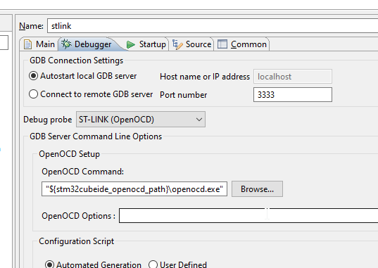

Further observations:
When opening older projects with STM32L4, now I encounter the same problems not starting a debug session other time. We never had this problems in the past. So why do older projects now starting to get problems?
I assume, that the STLINK driver / debugger module in cubeIDE has changed an now shows problems.
I can avoid this problem by switching to open OCD mode.
With open OCD mode, the debugger always starts properly on my STM32L4R7 project. (custom board)
waclawek.jan
Updates? Bad idea.
OK so we can now point to... what do you have the problem with, the GDB server?
