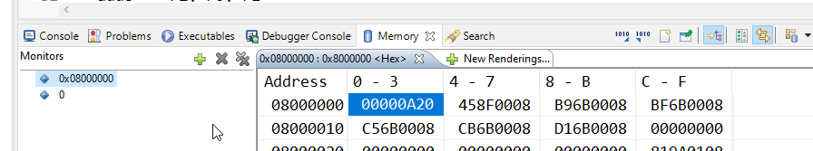

A few more critical observations. After experiencing the 0x1fff51f4 error I did the following:
1. Disconnect the debugger using the red "Terminate" button.
2. Used STM32CubeProgrammer to read the contents of flash at the start address of 0x08000000. Flash was not erased.
3. Power cycled the board. It boots and runs fine.
This tells me that there is no issue with flashing the code and that the bootloader isn't being executed because the flash is erased.
Also, I tried setting a breakpoint in Reset_Handler() on the first ASM instruction and clicking the "Reset" button. Breakpoint is never hit.

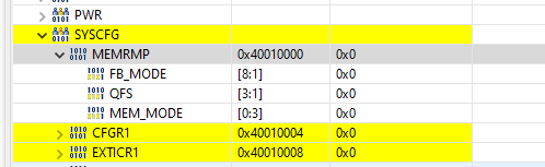

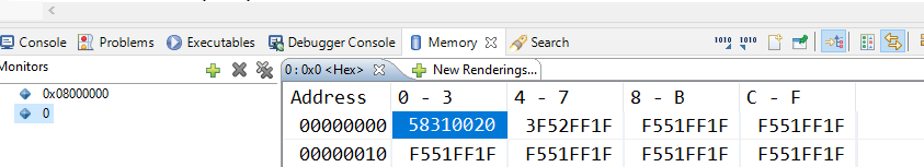

Johannes
Senior
June 15, 2021
Hello Everyone, thank you for your comments. To clarify:
  • My problems only occur when trying to do debug from CubeIDE with STLINKV2. When running the board stand alone it starts correctly every time.
  • i use STM32L4R7VIT6 on a custom board.
  • Boot0 Pin is tied to GND via 10k
  • Flash is not blank. I can read the flash content at address 0x08000000 every time, it is always good
    • the flash content is not mapped to address 0. Instead, the bootloader is mapped to address 0 every other time
  • I can read the content of VTOR register. It is always zero at start of debugging
  • I can read the memory remap register Syscfg/MEMRMP. It always shows zero, which means, the boot0-pin is correctly sampled, being low. This should result in flash memory being mapped to address zero for flash memory start
  • I can read every other time that the memory at address 0 does not show the flash memory content but the bootloader, despite the fact, that Boot0 Pin is tied to zero and Syscfg/memrmp is zero

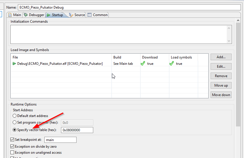

I have a solution for my situation:
I experienced, that the flash content is every other time is not mapped to 0x00000000 despite the fact, that the memory relocation register indicates, that flash should be mapped to 0x00000000. Every other time at 0x0000 0000 there is bootloader code. The Vector Table register VTOR still sets the Vector Table to 0x0000 0000. If an IRQ occurs, it would jump to bootloader instead of my program.
By setting VTOR to 0x0800 0000, the program runs fine with IRQs.
CubeIDE project settings has an option to set the VTOR register each time, the code starts.
void SystemInit(void)
#if defined(USER_VECT_TAB_ADDRESS)
 /* Configure the Vector Table location -------------------------------------*/
 SCB->VTOR = VECT_TAB_BASE_ADDRESS | VECT_TAB_OFFSET;
#endif
 /* FPU settings ------------------------------------------------------------*/
#if (__FPU_PRESENT == 1) && (__FPU_USED == 1)
 SCB->CPACR |= ((3UL << 20U)|(3UL << 22U)); /* set CP10 and CP11 Full Access */
#endif
But for this to happen, you need to set a global define USER_VECT_TAB_ADDRESS
This fixes the problem for me. The flash content is still not mapped to 0x0000 0000 each time, but the software starts each debug session properly.
