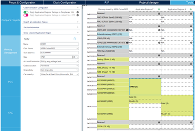

Reporting two issues when using STM32CubeMX v6.16.1 to generate STM32N6 code. I created new secure only template project for STM32N6570-DK to demonstrate the issue (it's attached).
Only changes to the new project are these:
In MMT defined RAM2 area over AXI SRAM3-6. Also check the "Apply Application Regions Settings to Peripherals".

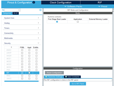

Then activated RIF for FSBL:
Now generate code.
