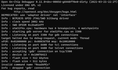

AOA Ahmed, I am facing a similar issue with STM32F407. My OpenOCD (gdb-server) is running remotely on Raspberry pi. Until STMCube IDE version 1.6 everything was fine. I updated it today to version 1.14 and it started giving this error. I have seen most of the posts in the context of bluepill. On OpenOCD side, i have these messages:
Can you please tell me how did you solve it?
